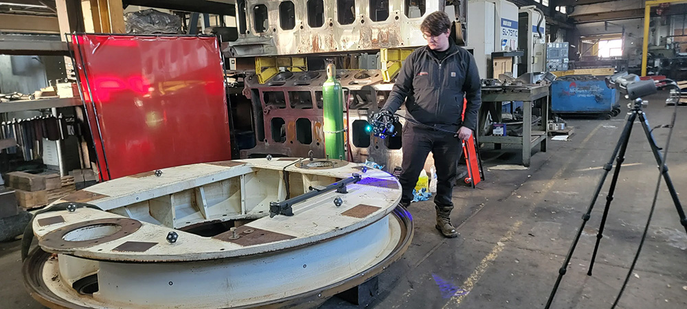

This inspection for reverse engineering was done in one day using a Shining 3D FreeScan Trak Nova. Multiple scan datasets were captured from different orientations to ensure complete surface coverage. This was followed by weeks of analysis from BMI’s engineering staff.

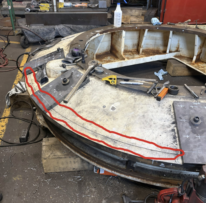

The repair
Visible in the picture above is a fracture along the top taper of the clarifier cover. Current metal-locking service (a cold repair process for cracked or fractured cast metal) is being performed to repair the component. Failure and load testing will need to take place following the metal locking repair. If the repair attempt is successful, a new unit won’t be needed. However, by reverse engineering concurrently with the repair, BMI has a head start should a new unit need to be fabricated.
3D data acquisition by FreeScan Trak Nova
Engineering and inspection
The clarifier cover was scanned with the FreeScan system at the top face, ID, OD, and bottom face. Resolutions of the captured data were at 0.1 mm and 0.2 mm with a metrology-grade accuracy of 0.02 mm (20 um). BMI was able to provide one day of onsite support to acquire a full polygonal model. The scan data were imported into PolyWorks, where the engineering team analyzed dimensional features, verified alignment surfaces, and identified all critical geometries needed for accurate reproduction. By combining several large scan files, the team ensured complete coverage and precise measurement of the component.
