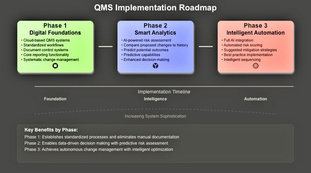

A three-phase approach to implementation strategy
Effective implementation of change control follows a systematic approach shown in the chart below.
Phase 1: Digital foundations—Develop cloud-based QMS systems that provide the underpinnings for systematic change management. This includes standardized workflows, document control systems, and core reporting functionality.
Phase 2: Smart analytics—Adopt AI-powered risk assessment systems that can compare proposed changes to the past and predict potential outcomes. Phase 2 provides predictive capabilities and additional decision-making functions.
Phase 3: Intelligent automation—Enforce full AI integration of change assessment, like automated risk scoring, suggested mitigation strategies, and best practices implementation sequencing.
