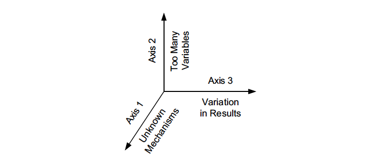

Three types of problems
Myron Tribus (former dean of continuing engineering education at MIT) once described the problems we face as falling in the space defined by the three axes of Figure 1 (below). Tribus elaborates that we are taught how to handle problems as if they lie along only one axis or another, even though, in practice, our problems tend to involve either two or three axes at once.
