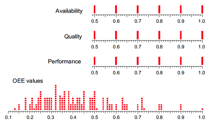

The Man of La Mancha never got to the unreachable goal—and if you’re being judged by overall equipment effectiveness (OEE), then your manager may also be dreaming an impossible dream. This column will look at problems associated with the use of OEE values.
OEE is a value often used in lean production. The concepts of lean production are built upon the implicit idea that we know how to operate our processes at their full potential. When this happens, process steps can be synchronized and production runs smoothly. However, processes don’t operate up to their full potential on their own. Full potential requires predictable operation, and predictable operation can only be achieved and maintained by process behavior charts.
