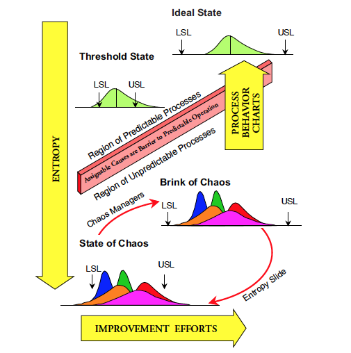

process behavior
Excellent article Dr. Wheeler!
I really like the way you explained and related the concept to Entropy...
"Process behavior charts" is a much better term than "control charts"....
