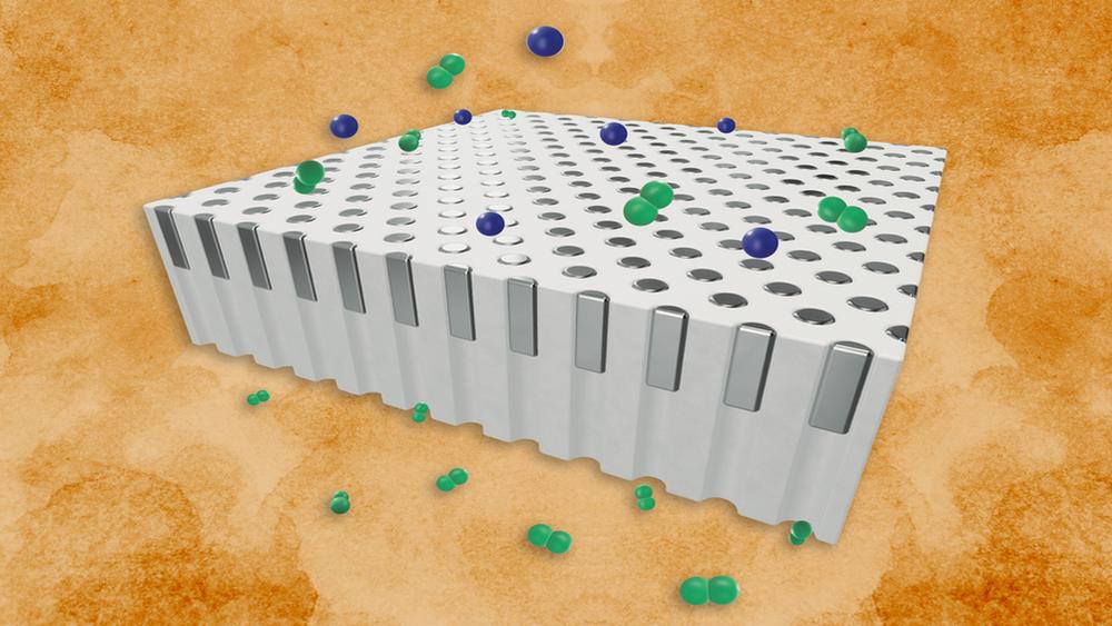

Schematic illustration of a membrane showing selective permeation of hydrogen (green) from a mixture of hydrogen and helium (blue) gases

Now, MIT engineers have developed a new palladium membrane that remains resilient at much higher temperatures. Rather than being made as a continuous film, as most membranes are, the new design is composed of palladium deposited as “plugs” into the pores of an underlying supporting material. At high temperatures, the snug-fitting plugs remain stable and continue separating hydrogen rather than degrading as a surface film would.

Illustration of a membrane filtering hydrogenPalladium plug membrane at the end of the membrane fabrication process (left). Dashed green lines outline the membrane. Scanning electron microscopy image of the membrane shows the palladium plugs embedded inside the pores of the silica support (right). Credit: Lohyun Kim
