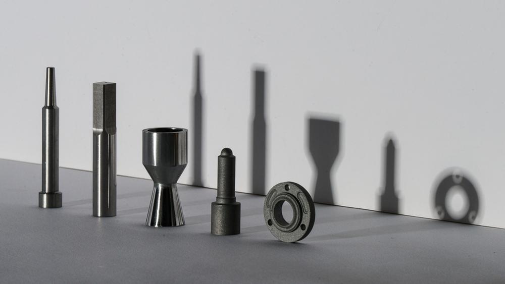

Today, Foundation Alloys starts with its customers’ material requirements and decides on a precise mixture of the powdered raw materials that every metal starts out as. From there, it uses a specialized industrial mixer—Guglin calls it an industrial KitchenAid blender—to create a metal powder that is homogenous down to the atomic level.
“In our process, from raw material all the way through to the final part, we never melt the metal,” Guglin says. “That is uncommon if not unknown in traditional metal manufacturing.
From there, the company’s material can be solidified using traditional methods like metal injection-molding, pressing, or 3D printing. The final step is sintering in a furnace.
“We also do a lot of work around how the metal reacts in the sintering furnace,” Guglin says. “Our materials are specifically designed to sinter at relatively low temperatures, relatively quickly, and all the way to full density.”
The advanced sintering process uses an order-of-magnitude less heat, saving on costs while allowing the company to forgo secondary processes for quality control. It also gives Foundation Alloy more control over the microstructure of the final parts.
“That’s where we get a lot of our performance boost from,” Guglin says. “And by not needing those secondary processing steps, we’re saving days if not weeks in addition to the cost and energy savings.”
