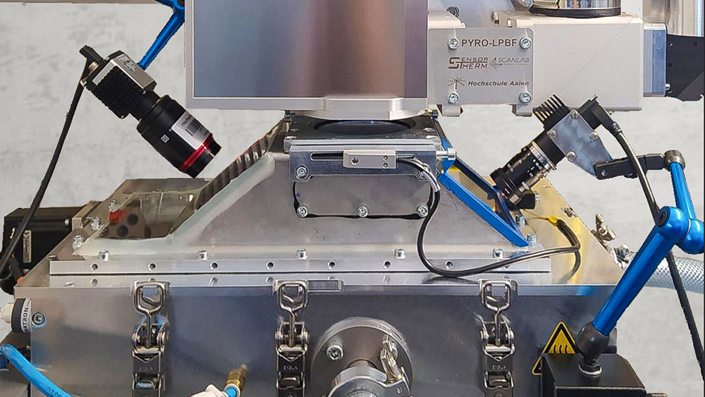

Test setup for additive manufacturing with IDS cameras U3-3040CP-C-HQ Rev.2.2 and U3-3990SE-M-GL Rev.1.2.

A key challenge is the precise analysis of the layer-by-layer laser melting process, which has a decisive influence on component quality. As part of research into increasing process stability and efficiency, students and scientific staff at the Laser Application Center (LAZ) at Aalen University are conducting a global, dynamic observation of the PBF-LB/M process. In the context of high-speed process control with temperature feedback, phenomena such as spatter and smoke formation, solidification behavior, and the safe movement of mechanical components during additive manufacturing are investigated.
This is supplemented by a high-resolution, static analysis of the remelted component layer geometries as well as precise detection of potential defects in the powder layers in order to draw well-founded conclusions about the resulting component quality. The imaging components of the research project are two high-performance USB3 industrial cameras from IDS Imaging Development Systems.
Two IDS industrial cameras provide the necessary image information
The two different tasks require different camera models. David Kolb, research associate at the LAZ, says, “We use a model from the USB3 uEye CP camera family for the global, dynamic observation of the PBF-LB/M process, e.g., of splashes or smoke formation. A USB3 uEye camera from the SE series is used for the static, high-resolution identification of anomalies within the powder layers and in the remelted component layer geometries.”

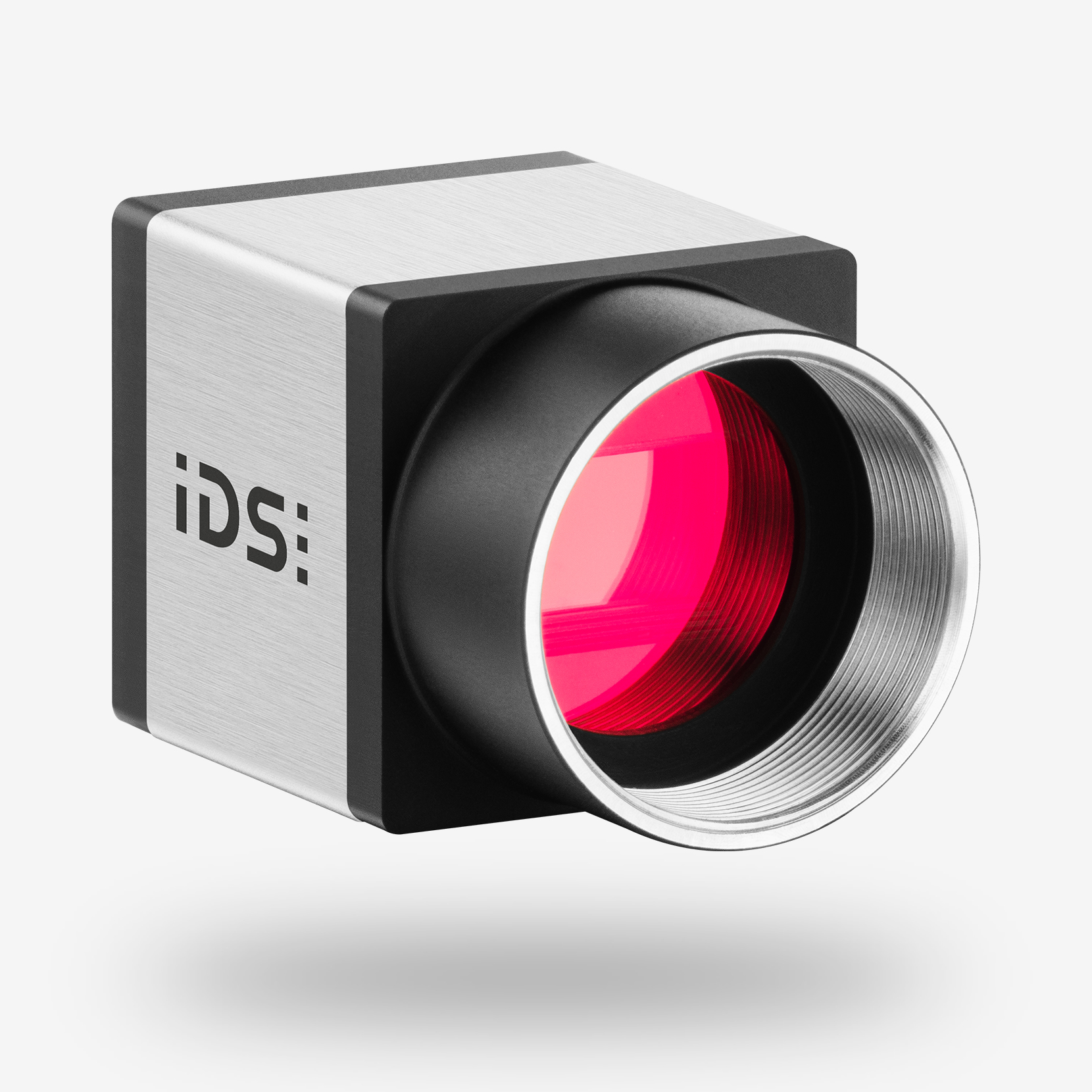

Explaining LAZ’s choice, Kolb says, “Since powder bed-based laser beam melting of metals is a highly dynamic additive manufacturing process in which the component is generated layer by layer, the following features were particularly important for global, dynamic monitoring: The camera must offer a resolution of more than 1,000 x 1,000 pixels and a frame rate of more than 100 fps, cover an image field of at least 100 mm x 100 mm, and have a trigger port for video recordings.”
The selected U3-3040CP-C-HQ Rev. 2.2 ensures excellent image quality, even in low-light conditions or when recording fast-moving objects.
The integrated IMX273 global shutter CMOS sensor from Sony’s Pregius range scores particularly well for its image quality, high sensitivity, and wide dynamic range. With a resolution of 1.58 megapixels (1,456 x 1,088 px), it achieves a frame rate of 251 frames per second—ideal for detailed video and image analysis of dynamic processes.

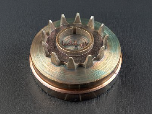

For the process parameter determination, cube-shaped components were additively manufactured, and the global manufacturing process was analyzed with the USB3 uEye CP camera. This made it possible to identify optimum laser parameters with which new types of soft magnetic components for more-efficient electric motors of the future can be produced from the difficult-to-process iron-silicon alloy with 6.5% silicon by weight (FeSi6.5). The stator half-shell made of FeSi6.5 based on this enables ideal adaptation to the special requirements of transverse flux machines, thanks to its optimized, three-dimensional magnetic flux guidance.
The high electrical resistance of the material and the design freedom of the PBF-LB/M allow a reduction in eddy current losses, increased power density, and the integration of additional functions such as cooling structures. Both the complex geometry and the brittle, soft magnetic material FeSi6.5 are almost impossible to produce or process using conventional manufacturing processes and require the use of additive manufacturing technologies.
Additively manufactured soft magnetic stator half-shell of a transverse flux machine made of FeSi6.5 on a construction platform. Image: IDS

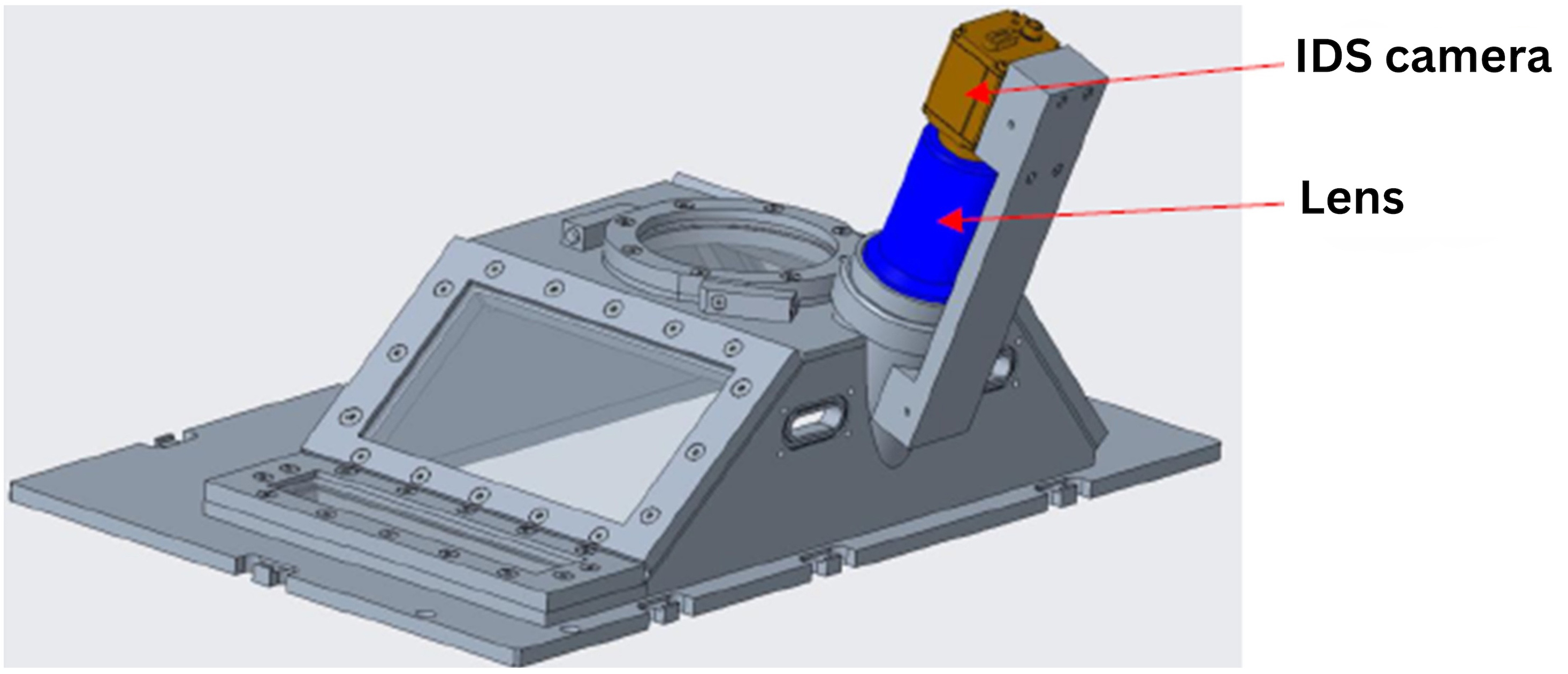

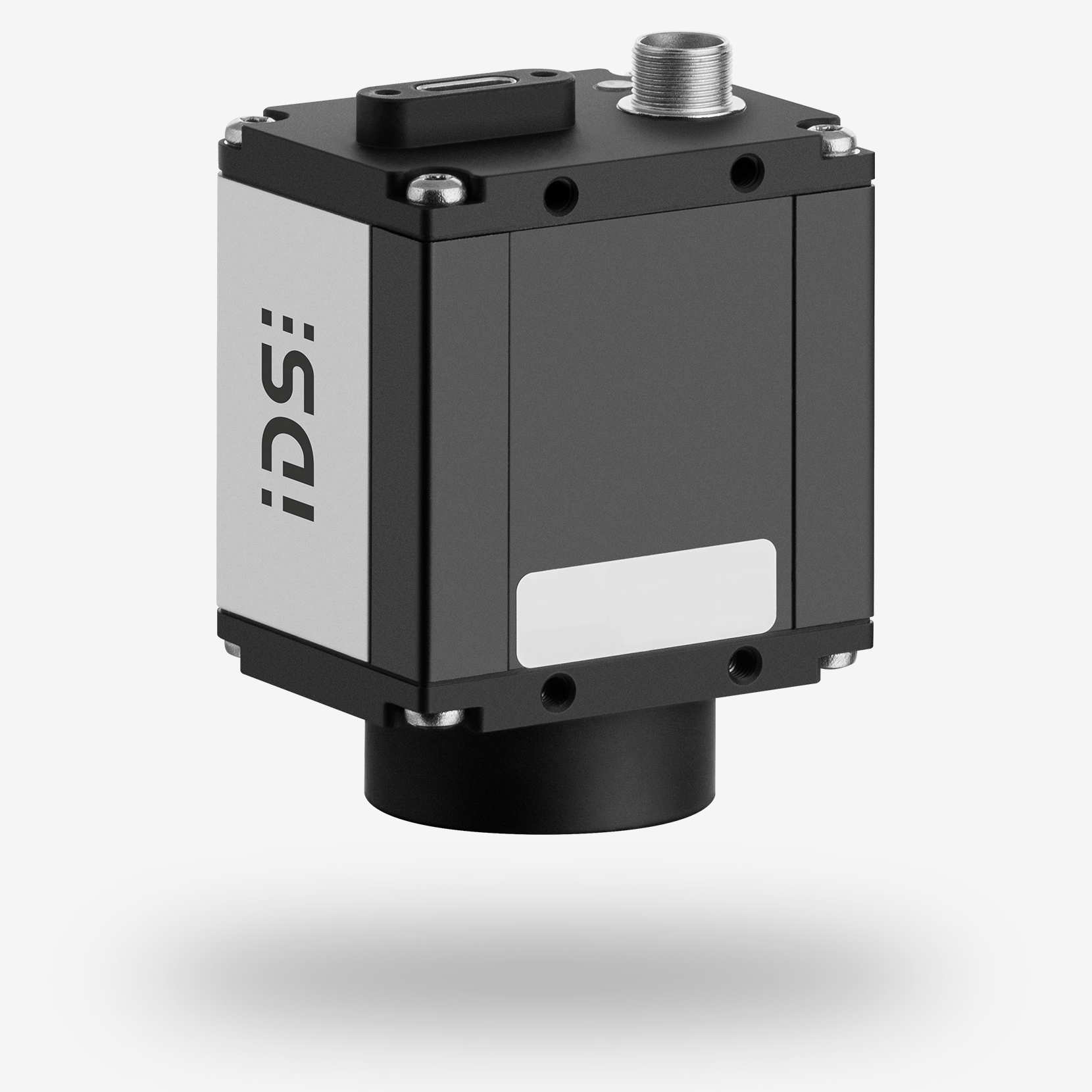

For static, high-resolution observation of powder layers or component layer geometries, the following camera properties are required in particular (in addition to a trigger port for single image recording): The sensor must be able to detect geometric features below 40 μm to identify defects in the layers while offering an image field of at least 100 mm × 100 mm and an image ratio that is as square as possible (1:1). This is exactly what the 20.36 megapixel (4,512 x 4,512 px) industrial camera U3-3990SE Rev. 1.2 delivers. With the IMX541, it has a high-performance, extremely high-resolution, large-format 1.1 in. CMOS sensor from Sony’s Pregius S series. The BSI (“back side illuminated”) technology used enables smaller pixels (2.74 μm) and a higher resolution, as well as improved quantum efficiency and sensitivity.
“Thanks to the particularly user-friendly and flexibly integrable IDS cameras, the necessary adjustments to the test setup could be implemented quickly and easily so that the USB3 uEye SE can be positioned at a defined angle,” Kolb says.
The near-vertical observation of the individual powder component geometry layers will provide valuable insights into component quality and potential manufacturing defects once the final adjustments have been completed. This way, crucial information about the properties of additively manufactured components can be obtained and used specifically to optimize manufacturing processes.
Design adjustments to the test setup for positioning the IDS camera U3-3990SE-M-GL Rev. 1.2 for static observation of the powder component geometry layers. Image: IDS

uEye CP in industry standard format 29 x 29 mm with patented housing design. Model used: U3-3040CP Rev. 2.2 camera family: uEye CP. Image: IDS
uEye SE “Standard Edition” all-round industrial camera with universal mounting options. Model used: U3-3990SE-M-GL Rev. 1.2 camera family: uEye SE. Image: IDS
