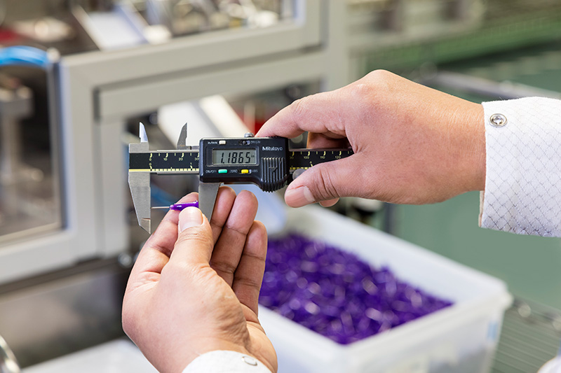

Each component must pass rigorous inspection: A poor-quality tip or nozzle can introduce unintended consequences such as fluid contamination into production, affecting fluid deposit accuracy.
Analytical fluid process testing is only one half of the quality equation. The construction of precision assemblies also requires everything from handheld dispensers to high-tech robotic dispensing systems. These solutions utilize single-use or one-part components based on individual assembly operations—syringe barrels, cartridges, pistons, nozzles, dispensing tips, and more. Nordson-engineered components are interoperable and quick to swap out, while ensuring tolerances are held and quality results are routine for system operators.
To make sure dispensed dots are the exact same size and micron-level fluid lines are identical, every touch point in the production process must have inspection rigor baked in, from first article inspection to the careful sourcing of raw materials, resins, and colors. Nordson technicians don’t need to adjust or change parameters or processes during operations, because even the smallest single-use component is made to stringent specifications. For example, syringe barrel pistons are meticulously engineered to optimize fluid flow consistency and seamlessly fit and seal within a dispensing system. Hundreds of studies have been conducted in Nordson laboratories to garner the best shape of a piston for fluid travel and maximum usage. Single-use components are also rigorously tested using a range of fluids with low- to high-viscosity parameters to ensure customers don’t waste expensive adhesives, greases, or other liquids they dispense.

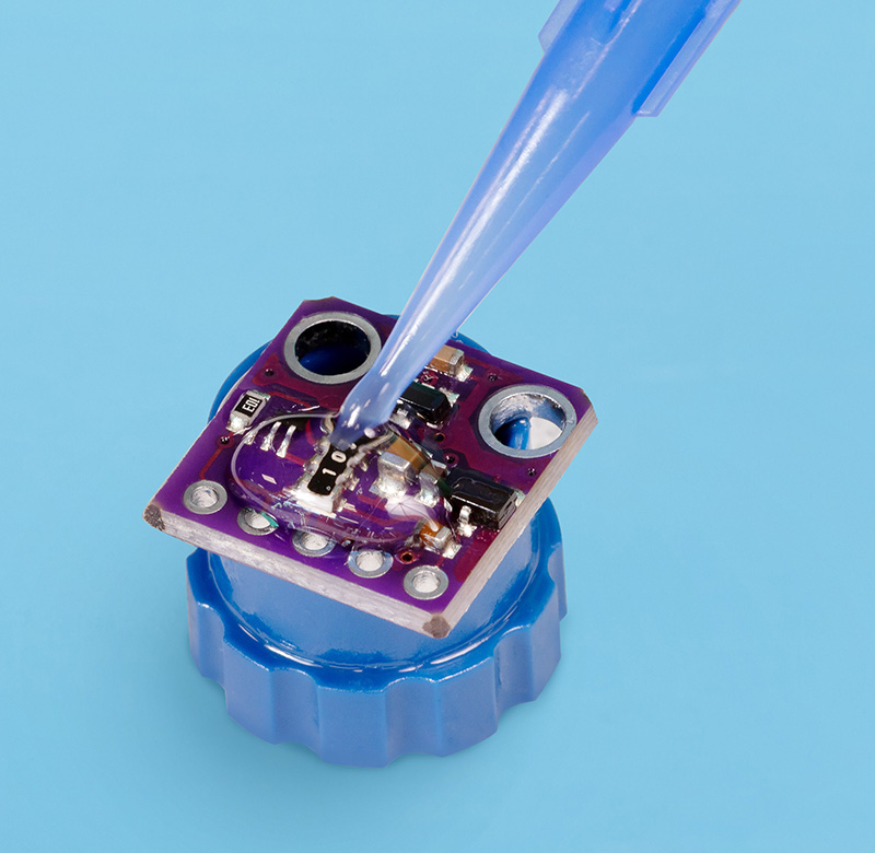

A two-component epoxy is being dispensed on a small medical device with embedded electronics.
These consumable products are found in clean mass-production assembly environments, veterinary practices, and fluid process labs. In these settings, a maximum level of cleanliness is required for fluid delivery as well as the assembly of products like medical devices and electronics. Therefore, single-use products cannot contain defects or contaminants. With an emphasis on purity with each fluid dispense, most of these consumables are manufactured in certified silicone-free facilities.
At Nordson EFD, the inspection process for syringe barrels is fully automated and captures data to analyze the results. If a barrel doesn’t meet product specifications, it will be discarded.
