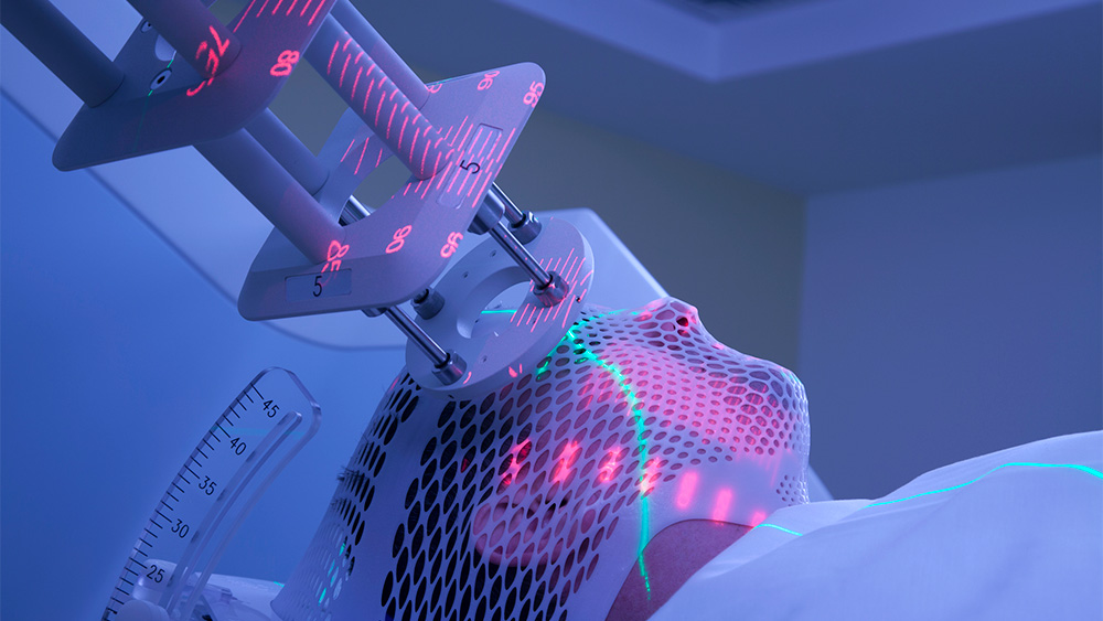

In the evenings, after patients have left for the day, our research team visits the radiation oncology offices at the University of Colorado Anschutz Medical Campus to talk to medical physicists about how our research can help cancer patients. We also run experiments in their radiation suites.
The radiation suites contain large machines that deliver high-energy X-ray and electron beams, known as accelerators. The rooms are surrounded by foot-thick concrete walls with sliding doors. The patient beds and accelerator heads move around in complex and precise motions to deliver radiation uniquely tailored to each patient and tumor.
Giving radiation to a cancer patient requires precise measurements. You need to give a lethal dose to the tumor and a nontoxic dose to the surrounding tissue. NIST researchers are working to improve these measurements, helping people with cancer live healthier lives after they complete their treatment. Credit: NIST
We arrive after the medical physicists have just finished a busy day. They test and calibrate the radiation systems. They also prepare radiation dose plans based on imaging and complex patient-specific calculations. Dose planning is a multistep procedure that requires accuracy and precision to ensure that the person gets the exact amount of radiation needed. You want to give a lethal dose to the tumor and a nontoxic dose to the surrounding tissue.

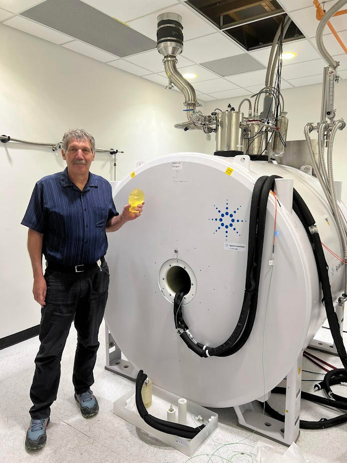

Stephen Russek poses in the lab holding a small model of a human head and standing next to the large cylinder of an MRI machine.
Stephen Russek with a dosimetry phantom in the lab. Credit: NIST

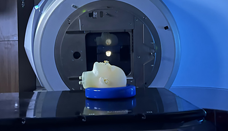

Back in our lab at NIST, we’re creating a human-head-shaped container filled with radiation-sensitive material. It’s called an anthropomorphic dosimeter. Anthropomorphic means it looks like a person, and dosimeter means it measures radiation.
The head replica, called a phantom, contains a special radiation-sensitive gel. The gel is mostly water, and it mimics tissue. The phantom also contains special polymers that change their chemistry when exposed to radiation.
The phantom can be thought of as a three-dimensional radiation-sensitive photographic film. When radiation hits parts of the phantom, we can record changes in the film. We do this using a special type of MRI that provides data and measurements, not just pictures, known as quantitative MRI. It’s our expertise in quantitative MRI that brings this new opportunity to radiation dosimetry.
Using the quantitative MRI rather than a traditional MRI, we can better measure where and how much radiation is deposited and use this information to verify the accuracy of dose plans. We’re planning to use these gels to study different types of radiation, such as X-ray, electron, proton, ultrasound, and microwaves. We hope to better understand how and where they are absorbed in the body.
