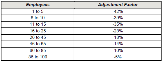

What medical device company that sells internationally wouldn’t want a yearly one-and-done audit that satisfies the regulatory requirements of those five countries? Within the medical device community, where audits are strict and often expensive, the ability to go through a single quality management system (QMS) audit and have those audit results accepted by five countries would theoretically save time and money compared to dealing with each country’s regulations individually. That was the intended goal behind the Medical Device Single Audit Program (MDSAP). However, as is the case with many plans, the unintended consequences may hurt not just the medical device companies it was supposed to help, but in the end may harm consumers.

I liked your article which articulated all the concerns I have had over the past two years.  My NB/AO failed to respond for 12 months and then the 5-9 days of audit I was anticipating suddenly became 13.  This makes our sales to Canada non-viable.  I am pushing to establish if my quotation included the HC percentage reduction for our small firm but no answer as yet.  I wouls be interested to hear if HC move their stance any more.  My email to them just suggested I try another AO...  Regards, Steve
