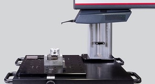

(Mahr: Providence, RI) -- It’s possible to measure roughness and contour features in just one pass with the new MarSurf SD 140 AG 11 surface measuring device from Mahr.
The heart of the MarSurf SD 140 AG 11 is the newly developed tactile touch probe. This can record the measured values for roughness and contour at the same time, which the software then evaluates separately. The probe-arm measuring range covers 10 mm (100 mm probe arm) and 25 mm (200 mm probe arm), and the measuring force from 0.7 mN to 30 mN can be set via software.
