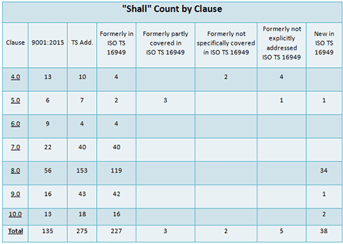

When evaluating a new draft standard against the current ISO/TS 16949, the following forces come into play (figure 1):

Hello Chad:
Please will you further define the chart column headers that start with the word "Formerly"? Or maybe you can spend some time in the webinar describing the column headers?
I look forward to the webinar.
