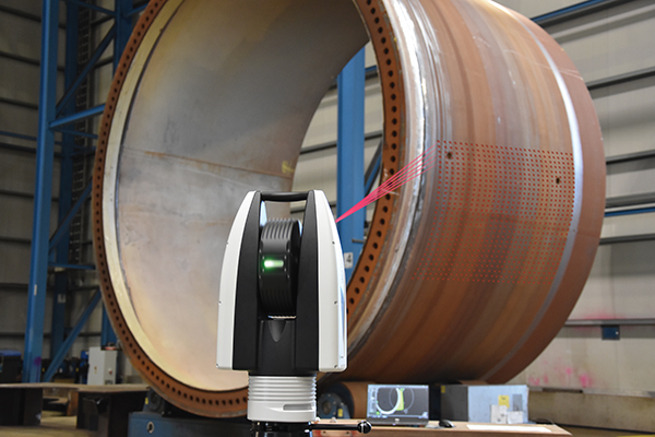

(Hexagon Manufacturing Intelligence, North Kingstown, RI) -- Hexagon’s Manufacturing Intelligence division today launched a brand-new laser tracker line, the Leica Absolute Tracker ATS600. This product introduces a new concept in metrology-grade laser trackers, with targetless 3D scanning possible for the first time directly from the laser tracker. The ATS600 can scan a surface with metrological accuracy from a distance of up to 40 m with no need for targets, sprays, reflectors, or probes.
Following in the footsteps of the Leica Absolute Scanner LAS-XL that was released in 2017, the ATS600 delivers as much accuracy as is needed by targeted metrology applications, with its focus more on measurement usability and processing speed. Previously difficult-to-reach areas are simply measured without even the need for tracker repositioning, while surfaces that would previously have taken hours to manually scan can now be digitized in minutes.
