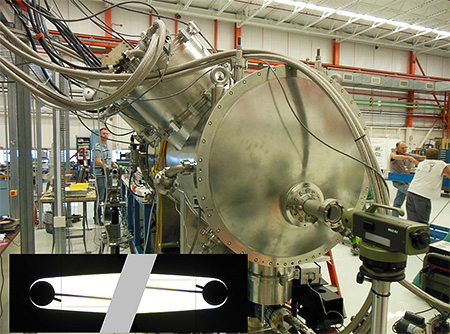

Several different types of instrumentation are used for the internal measurement and alignment of SC devices. Traditional optical telescopes, wire position monitors (WPMs), and lasers have all been successfully employed. Portable 3D coordinate measurement instruments, such as laser trackers and articulating arms, are used extensively during warm alignment of SC devices, when the cold-mass components are accessible. Once a cryostat is closed, access for measurement is limited to vacuum viewports and alternative methods are needed. Telescopes and open-wire or other optical targets are preferred over WPMs because the optical method provides comparable accuracy at a much lower cost. Laser displacement sensors (LDSs) have also been successfully used to measure thermal shift in SC devices. A novel 2D laser scanning system that employs LDSs to acquire 3D thermal shift information is currently under development at Argonne.
Optical instruments
Optical instruments used for measurement of internal SC device components include optical levels and alignment telescopes. In SCUs, only the vertical shift (Y), pitch, and roll are measured, while with SRF devices measurements of both the horizontal and vertical (X and Y) directions as well as pitch, roll, and yaw are made.
Internal cryostat measurements for SCUs are short-range, less than 1 m, and the targets are ~100 mm apart. Instruments are set up in the same position and elevation for repeatability. The first SCU developed at APS had no viewports; thermal shift was measured with an optical level by viewing spherical targets placed directly inside of the electron-beam vacuum chamber. Newer APS SCUs have side viewports and targets mounted on the vacuum chamber that allow accessibility for measurement throughout assembly, testing, and installation. Figure 3 shows an optical level set up to view internal cryostat targets in an SCU.
Figure 3. Optical level set up to view internal cryostat targets in a SCU; inset photo is of spherical beads in a prototype SCU vacuum chamber taken through the optical level eyepiece
Thermal shift measurements for SRF devices are far more difficult to accomplish than those for the SCUs, with multiple open-wire targets over a 5-m range. Open-wire targets are used because they may be placed along a common line of sight without introducing optical distortion. In the case of the ATLAS Intensity Upgrade (AIU), limited headroom after installation required the use of a periscope attachment on the alignment telescope, with the scope set up perpendicular to the reference line. Further details regarding optical measurement of SC devices will be discussed in the following SCU and SRF sections.

Vacuum windows
Measurement of cold components within a cryostat or cryomodule requires a transparent medium between the cold vacuum space and ambient air, introducing a source of uncertainty. Precision measurement requires a higher level of quality than is available in off-the-shelf vacuum viewports with a typical parallelism specification of about 30 arc-minutes. Nonparallel surfaces on standard vacuum windows create an optical wedge that changes the angle of the line of sight as it passes through the window. Plano-parallel windows introduce only a parallel displacement of the line of sight that remains constant over distance.4 Optical micrometers used in optical tooling transits and precision levels rely on the same principle.
High-quality windows are used for precision measurement of cold components inside SC devices. The parallelism specification is <10 arc-seconds for targets at close range, <1 m, and <1 arc-second for measurement of multiple targets over a range of 1 m to 5 m. Small windows, <75 mm in diameter, are used to minimize deflection of the planar surfaces due to vacuum differential forces as well as to limit thermal radiation from heating the SC system. Measurements taken through the windows are secondary, used to detect relative shift under vacuum in warm and cold conditions. Internal targets are measured for absolute position before the windows are installed.
After a window is installed, optical or laser measurements are taken very close to normal incidence with the window surface to minimize refraction. In SCUs, refraction effects on the line of sight introduced by glass and vacuum are recorded and compensated. Thermal shift measurements in SRF devices reference lines of sight established using fixed targets located within the vacuum space. Two reference axes are established at room temperature and under vacuum using open-wire targets rigidly affixed behind the viewports, at each end of the cryomodule vessel. Fiducial targets attached to the SC components are measured in X and Y with respect to each reference axis. After the cryomodule is cooled to 2 K, the fiducial positions on each device are compared to the original measurements at room temperature. The thermal offset is the difference between these measurements. Notice that refraction effects are constant throughout the measurements.

The thermal shift for SCU0 was measured using an optical level looking directly into the aperture of the beam chamber through glass viewports. Seven pairs of 3 mm-diameter spherical bead targets placed inside the chamber at set locations were spring-loaded with stiff wire to engage the racetrack profile in the horizontal plane, as seen in the figure 3 inset photo. By observing the sphere top and bottom tangents, the shift of the beam chamber was characterized over a thermal cycle. The thermal shift as well as the shift resulting from vacuum pressure differentials was measured and corrected. Initial warm measurements made under insulating vacuum indicated that the ambient pressure on the bellows connecting the LHe tank to the top of the cryostat had lowered the chamber by 0.30 mm, with approximately 0.1 mrad of pitch introduced. After the system was cooled down to 4 K, the beam chamber measured about 0.90 mm below the initial reference with a pitch of about 0.2 mrad, primarily as a result of Kevlar expansion. When SCU0 was warmed back up to room temperature, the vertical position was 0.35 mm below the reference with a 0.1 mrad pitch. The cryostat was then cycled up to atmosphere and back to insulating vacuum. After this cycle, the chamber was 0.25 mm below the starting reference with a pitch slightly greater than 0.1 mrad. The SCU alignment tolerances are shown in the table in figure 5.6,7
Figure 5. Table showing SCU alignment tolerances6
To control and minimize thermal shift of the cold-mass assembly, the Kevlar bands were shortened and aluminum links were added. Figure 6 shows the modified suspension system from both ends of the cryostat vessel. The length of the aluminum was calculated to compensate for the elongation of the Kevlar, the contraction of the cold mass, and the shift caused by pressure differential forces. Calculated values were verified during the next cycle, which takes about 190 hours (8 days) to complete. Measurements using the spherical beads could not be repeated, but monitoring was incorporated into the magnetic measurement procedure. Magnetic mapping of SCU0 involves stretching a titanium (Ti) tube through the beam chamber centerline. The Ti tube guides a carbon-fiber tube with a magnetic Hall probe and fiber-optic target at the end of it. The carbon-fiber tube is guided by a long translation stage mounted to a fixed measurement bench. The centerline used for the test is defined by the axis traced by the translation stage travel. A micro-alignment telescope with dual-axis micrometer was utilized to monitor the fiber-optic target traveling through the Ti tube. This method, although less accurate than the spherical beads, proved that the suspension system modified with the aluminum links maintained the vertical position of the beam chamber during the cooling process, practically negating thermal shift with less than 0.1 mm observed.7

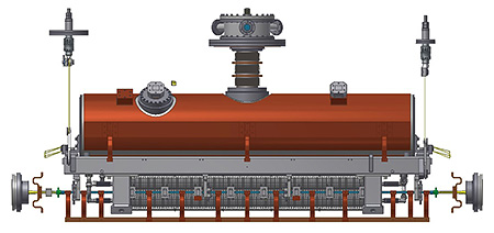

In the second SCU (SCU1), modifications were made to the measurement approach, including the addition of two vacuum viewports located on the side of the vessel and target tabs attached to either side of the beam vacuum chamber (as seen in figure 7), allowing access for measurement and adjustment throughout the assembly, testing, and installation. The spherical bead method was not used in SCU1. The improved multiple-wind Kevlar bands were used, but the Al links were not redesigned. Vertical thermal shift was measured after initial cool-down through the side viewports using an optical level, and a change of –0.35 mm upstream and –0.42 mm downstream was observed and corrected. After installation and cool-down in the APS storage ring, measurements of the vacuum chamber elevation indicated the upstream end was at –0.03 mm and the downstream end was at –0.14 mm with respect to the ideal position. As of this writing a third device, LCLS-SCU, is in the process of assembly, and the same measurement strategy employed in SCU1 will be utilized.
Figure 7. SCU1 cryostat vessel with side viewports added; insets show internal targets mounted to the beam vacuum chamber

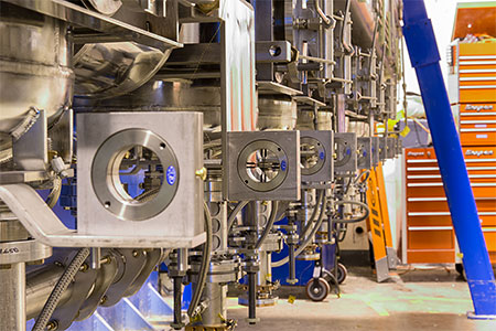

SRF cryomodules
SRF technology is extraordinarily complex and relies on knowledge and expertise from across a wide range of scientific and engineering disciplines. Advanced SRF technology is making it possible to build high-power compact electron, proton, and ion linear accelerators for isotope production facilities, accelerator-driven systems for nuclear waste transmutation or power generation, and high-intensity proton accelerators for industrial and homeland security applications. For inertial fusion, SRF accelerators could compress and ignite fusion targets by ion beam bombardment and serve as efficient drivers for fusion reactors. High-power proton and ion beams are required for the development of new radiation resistant materials for future reactors. High-power accelerator beams can also drive the next generation reactors that burn non-fissile fuel, such as thorium.8
SRF-resonant cavities produced at ATLAS are constructed of formed, welded niobium and stainless steel. The niobium cavities are encased in stainless steel vessels and the annular space between the outside of the niobium cavity and the stainless steel jacket is filled with the liquid helium coolant for operation at 2 K to 4 K. When RF energy is applied to the cavity at the design frequency, the resonant fields can accelerate charged particles by a few million volts while dissipating only a few watts of RF power in the heating of the cavity walls.
SRF cryomodules present difficult challenges with regards to alignment. Multiple SRF cavities and SC solenoid magnets are individually aligned in kinematic couplings mounted on a large titanium strong-back rail structure that is suspended by titanium rods from the lid of the cryomodule vessel. The entire assembly is top-loaded into the vessel. Figure 8 shows a SRF cavity string in a strong-back assembly, and figure 9 shows a SRF cryomodule vessel.

ATLAS energy upgrade
The ATLAS Energy Upgrade (AEU) was commissioned in July 2009. The SRF components were hard-mounted to the strong-back structure in an over-constrained assembly. Upon cool-down, chaotic shift in both translation and rotation of components was observed. Components were initially aligned to ± 0.1 mm; however, as a result of thermal shift the final alignment quality decreased to random errors of ± 0.5 mm, with pitch and yaw errors of up to 0.5°. It was decided that subsequent cryomodule designs would eliminate over-constraint in the mounting system and employ kinematic couplings to better control and direct thermal shift.
ATLAS intensity upgrade
Kelvin-type kinematic hardware specified for the AIU cryomodule (as seen in figure 12) was an improvement to the over-constrained system in the AEU; however, problems were encountered during the warm alignment process. The SRF cavities are ultra-clean, and must remain under vacuum to prevent contamination. The vacuum forces worked against the alignment system, lifting the cavities out of their kinematic mounts. The pressure differential forces are cancelled when the assembly is under insulating vacuum inside the vessel, but it was necessary to pre-load the kinematic couplings with threaded rod connectors when aligned warm. Additionally, the couplings were slightly overloaded, with SRF cavities weighing nearly 400 lbs resting on three 1-in. diameter spheres, introducing potential problems due to Hertzian contact stresses. The Kelvin clamps specified for the AIU control thermal shift, but corrections were applied for both X and Y due to the arrangement. The cavities and solenoids were aligned to a common axis in warm conditions at an offset from the beam axis of –0.4 mm in X and –3.6 mm in Y. The offsets compensate for the calculated thermal contraction of the cold mass and shift of the titanium strong-back due to the deflection at the hanger attachment points on the cryomodule lid with the application of vacuum. Warm alignment was accomplished using a variety of metrology instruments, including optical tooling transits, optical levels, a laser tracker, and an articulating CMM.
During warm alignment, 22 open-wire target fiducials attached to the cavities and solenoids were located both optically and with the CMM arm by tracing the diameter with the probe. Figure 13 shows open-wire targets mounted on one side of the assembly. Open-wire targets were also mounted behind each vacuum viewport within the cryomodule vessel to provide a fixed reference line. The fixed targets were referenced to the cryomodule centerline. After the cavity string was loaded into the cryomodule box the target positions were measured through the viewport tubes without the glass windows in place. The open-wire targets were measured through the viewports on the cryomodule box before and after evacuation of the cryomodule and the subsequent cool down. At ambient temperature the solenoids showed a horizontal variation of 0.08 mm RMS and a vertical variation of 0.17 mm RMS with respect to the warm axis. The pitch and yaw of the solenoids were measured to be 0.03° RMS and 0.08° RMS, respectively. The room temperature alignment results of the cavities, for which four times looser tolerance than the solenoids are allowed, are 0.36 mm RMS in X, 0.21 mm RMS in Y, yaw of 0.07° RMS, and pitch of 0.15° RMS.10
Figure 12. Seven SRF cavities and four SC solenoids mounted on the strong-back (blue) with their own kinematic-alignment hardware (orange for cavity and yellow for solenoid); four titanium suspension rods are hung from the cryomodule lid which is transparent in this model view
Figure 13. Open-wire optical targets mounted to SRF cavities and solenoids in the strong-back assembly
Measurements of the open-wire targets for vertical shift on evacuation of the cryomodule and the subsequent cool down showed the expected behavior. The average shift of the solenoid targets is 3.57 mm and it is in good agreement with the calculated shift of 3.60 mm, which is derived by thermal contraction of the cold mass and vertical shift of the lid due to vacuum pressure. Note that some cavities have two targets, but others have only one, whereas all solenoids have two targets, which is as many targets as is practical. For the devices which have two targets, average measured displacement was used. A yaw of 0.01° over the entire strongback is observed, and it is thought to be due to imperfect dimensions of the formed titanium sheets used in the strong-back. Nevertheless, this yaw could be compensated by adjusting the cryomodule vessel position to place the average horizontal shift of the solenoid centers at 0.38 mm, which is in good agreement with the calculation of 0.40 mm. The deviation is 0.09 mm RMS for the solenoids and 0.26 mm RMS for the cavities. The alignment errors induced at cool down are combined with the room temperature alignment errors for final alignment errors that are summarized in the table in figure 14.10
