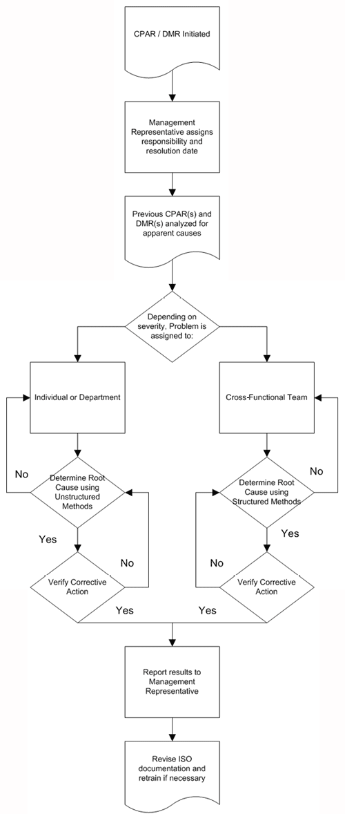

ABC Company Work Instruction
Purpose: To determine root cause for external nonconformance (customer complaints), internal nonconformance (rework, sort, subcontractor), and quality audit nonconformance findings.
Work description: Nonconformance-generated CPARs and DMRs are analyzed for apparent causes and root causes to determine corrective and preventive action to eliminate the problem and continuously improve the manufacturing process.
Safety considerations: Observe all written and oral safety instructions, appropriate checklists, and guidelines. Follow safe workplace practices.
Maintenance: None
Special Procedures: Check previous customer, internal, and quality audit CPARs and DMRs before proceeding with root-cause analysis.
Unstructured Methods
Intuition
Networking
Experience
5-Whys
