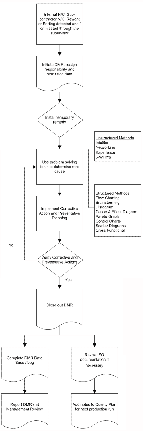

ABC Company Work Instruction
Purpose: To initiate a DMR for internal nonconformance, subcontractor nonconformance, rework, or sorting.
Work description: A DMR is used to determine the nature of defect(s), establish a temporary remedy, determine the apparent root cause, establish corrective action, and do preventive planning for internal nonconformance and subcontractor nonconformance.
Safety considerations: Observe all written and oral safety instructions, appropriate checklists, and guidelines. Practice safe workplace practices.
Maintenance: None
Special Procedures: None
