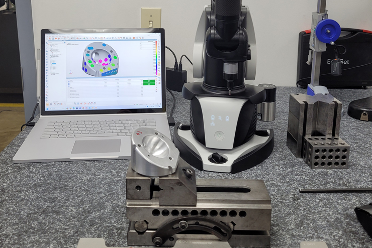

He decided to try programming the CMM using one of the CMM plug-ins included in PolyWorks|Inspector. Although Unger had previous PolyWorks experience taking dimensions with a portable arm, “I had no programming knowledge on a CMM,” he says. “I did some investigating on YouTube, watched the training videos, and sat down and started programming on the CMM. It was that easy for me and much easier than what we were typically doing at the time.”

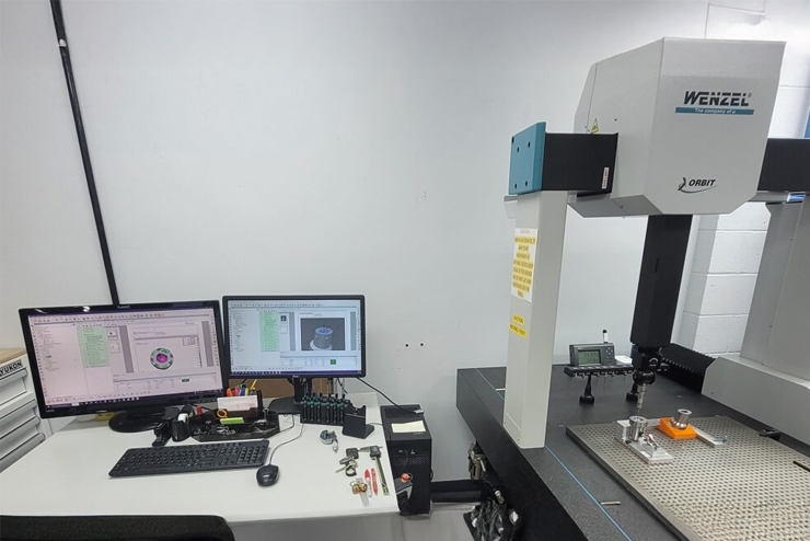

Humanetics’ quality control team uses PolyWorks|Inspector with a Wenzel XO55 CMM to measure parts. (Image: Humanetics.)

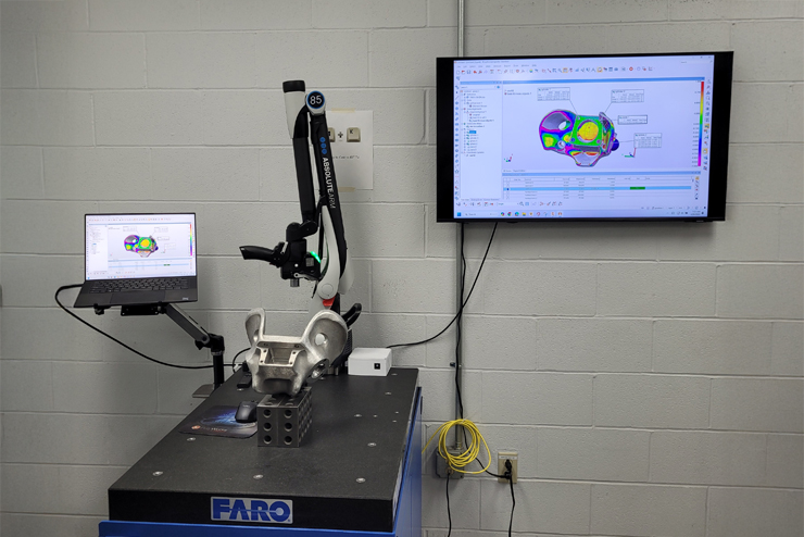

Scanning a pelvis bone using a Hexagon AS1 3D scanner and PolyWorks|Inspector. (Image: Humanetics.)
“Capital equipment decisions at Humanetics, particularly in a period of high growth, are now driven by the question ‘Does it integrate with our software?’,” Unger added. PolyWorks|Inspector runs on Humanetics’ portable arms, CMM, and 3D scanning equipment, making sharing precise data from multiple sources more efficient.
