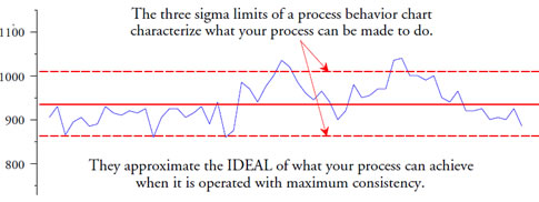

The ideal
The first question is: What do you want to accomplish? Until you have a clearly stated objective, you risk everyone running off in different direc­tions, working on their own pet projects, and not coop­erating for the common good.
