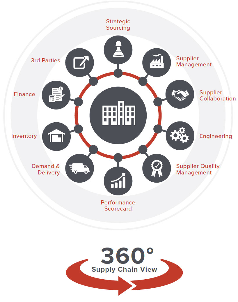

Figure 2: Click image to enlarge
To ensure sustainable, improved supply chain performance, especially as the automotive industry becomes more consumer-focused and the velocity of the supply chain activity increases, automating and integrating key business functions and processes is critical. Despite the availability of fully integrated ERP solutions, manufacturers tend to implement piecemeal solutions or develop in-house systems that can be myopic in their application, only addressing isolated business functions. This partial application of automation creates the need for interface activities, especially in supply chain planning, which often are filled by Excel spreadsheets or require interfaces to an enterprise resource planning (ERP) system.
The problem with incremental and manual solutions is that they are not in sync, up to date, or readily accessible by all functions requiring such data. Adopting a 360-degree enterprise view of the supply chain (see figure 2) provides real-time data across key business activities. Most important,enterprise ERP solutions provide virtual integration of these essential supply chain processes with related key business activities, leveraging data across functions for better risk management and decision making. A fully integrated ERP also provides the basis for adopting advanced technologies to improve the efficiency of essential supply chain tasks and facilitate the use of analytics.
