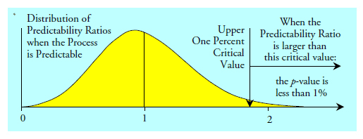

Story update 1/15/2019: Thanks to the sharp eye of Dr. Stan Alekman, who spotted an inconsistent value in figure 2, I discovered an error in the program used to construct the table of critical values for the prediction ratio. I have now corrected that problem and updated the entries in the table in figure 2. If you previously downloaded this column, you might want to download the corrected version below.
Software packages use p-values to report the results of many statistical procedures. As a result some people have come to expect a p-value as the outcome of any statistical analysis. This column will tell you how to compute and use a p-value for a process behavior chart.
