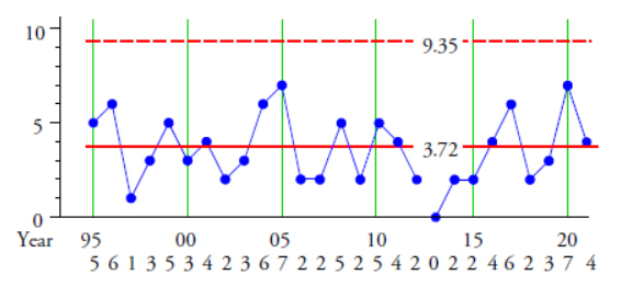

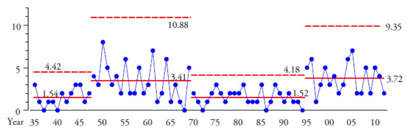

Control Limits Breakpoints
Dr Wheeler,
Excellent article.  As a MBB, I always instruct problem solvers to gather all aspects of the data (who, what, where, when) in order to plot it many ways, and always get the temporal understanding of the data so it can be plotted on a time series plot.
My question is about determining the breakpoints to create new control limits as shown in Figure 5.  Is there a certain rule to determine when to create new control limits or is just a trial and error method combined with observing natural breakpoints?  On Figure 5, it looks obvious, but I can imagine a lot of cases where it is not so obvious.
Thanks.
Submitted by Bill Sproat on Tue, 01/04/2022 - 13:41
In reply to Control Limits Breakpoints by tedcg8r
Breakpoints
Dr. Wheeler will be able to address your question much better than I, but I have a few thoughts to consider.
- Plot without any breaks and the signals in the behavior chart will give clues about when breaks have happened (use Western Electric or other rules to find signals).
- Make sure signals are breakpoints of trends and not individual or tightly clustered extraordinary causes.
I have done this with many processes and found shifts in the behavior charts.  After investigating the circumstances around the breakpoint timeline, I've often found that:
1) intentional changes were made to the process that were assumed to have no effect on this particular metric
2) unintentional changes were made to the process by new operators, maintenance, even the weather (seasonal changes)
