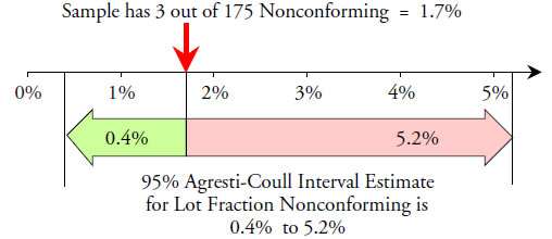

Acceptance sampling uses the observed properties of a sample drawn from a lot or batch to make a decision about whether to accept or reject that lot or batch. Although the textbooks are full of complex descriptions of various acceptance sampling plans, there are some very important aspects of acceptance sampling that are not included in the textbooks.
Extrapolation
In the interest of simplicity, the product that has been measured will be referred to as the “sample,” while the product that hasn’t been measured will be referred to as the “lot.” Every time we attempt to use a sample to characterize the quality of a lot, we will be making an extrapolation from the product that has been measured to the product that hasn’t been measured.
