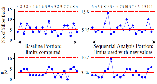

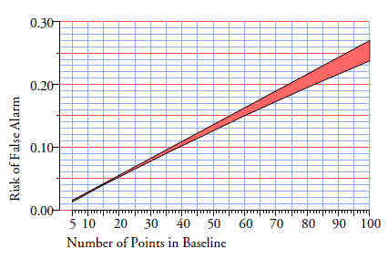

Like all process behavior charts, the XmR chart was designed for the sequential analysis of a continuing stream of observational data. Here the data will generally represent one condition, and the purpose of the chart is to identify unplanned changes in the underlying process. After the baseline period, where we compute the limits, we extend the limits forward and continue to add data to the chart. Each time we add an additional point to the chart we are performing an act of analysis. Each of these analyses asks if the current value is consistent with the baseline period. And, as with all sequential procedures, we want to perform each of these acts of analyses in a conservative manner in order to reduce the overall risk of a false alarm.
