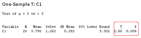

If you’re not a statistician, looking through statistical output can sometimes make you feel a like you’ve wandered into Alice in Wonderland. Suddenly, you find yourself in a fantastical world where strange and mysterious phantasms appear out of nowhere. For example, consider the T and P in your t-test results.
“Curiouser and curiouser!” you might exclaim, like Alice, as you gaze at your output.
Figure 1: One-sample T: C1
What are these values, really? Where do they come from? Even if you’ve used the p-value to interpret the statistical significance of your results umpteen times, its actual origin may remain murky to you.
