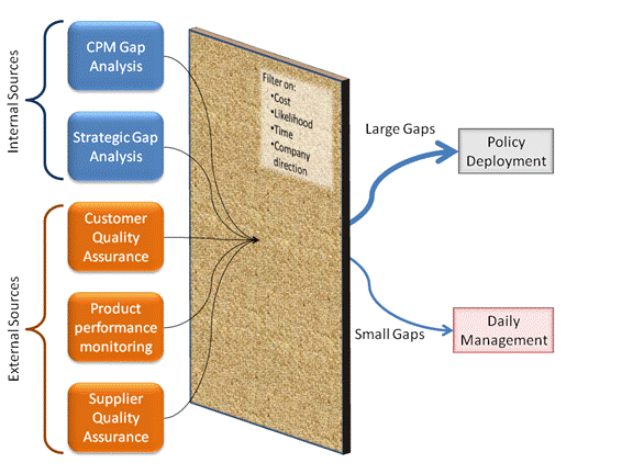

The model I use to identify potential projects is summarized by Figure 1 below.
Figure 1: Project Selection Model
Internally, you examine your critical performance metrics (CPMs) and gaps between where you are and where your company strategy is driving you. By listening to this “voice of the business” you can identify areas that will require work to meet your business objectives. Ignoring the internal measures and focusing only on external measures, such as customer satisfaction, can lead to going out of business with very happy customers. One very useful internal metric is asset utilization, which I wrote about in Top Ten Stupid Six Sigma Tricks #8.
Externally, your market intelligence system gathers data on how your product is performing and how customers perceive the quality of what you provide, as well as unmet needs that you might be able to meet (the “voice of the customer”). Be cautious of only having a reactive system. Ideally, both systems will actively query customers and generate performance benchmarking to serve as an early-warning system for problems and opportunities you currently don’t know exist. Your supplier quality assurance system also generates potential projects by examining supplier performance against requirements as well as the interaction between suppliers and your processes.
All of these potential project ideas need to be filtered by:
  • Cost to achieve success
  • Likelihood of success
  • Time required to capture benefits
  • Company direction, e.g. showing that this project will help move the company toward its goals
