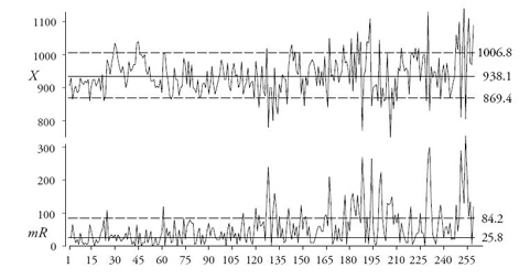

Submitted by Dan Altenloh on Tue, 04/06/2010 - 08:49
In reply to Comment by Steve Moore
Use of XmR Chart
Just a note to the prior comment. Actually, the process behavior chart is used throughout the DMAIC. The first step is to define the project ('D'). Often, one sees a chart like the one shown in fig 6 in the article and would certainly want to place this process step on the list of possible projects. If the cost impact vs probability of solving places the project as one of the best improvement opportunities, then a project would be started. SPC charts are great sources of historical data to determine that a project needs to be started. Of course, they are then used later in the 'I' and 'C' phase to measure the project's success.

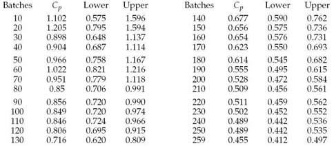

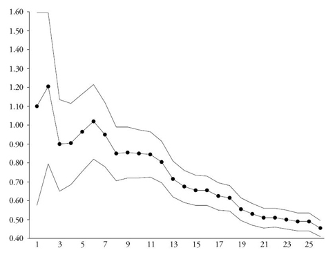

Submitted by Frank Deruyck on Wed, 04/07/2010 - 00:25
Spread index Cp
If one would succeed in stabilizing this process, according to the process capability 6s from individual X-chart a Cp = 140/137,4 = 1,019 is computed; indeed amazing that the time estimated Cp does not converge to this value but to a significant lower level! Could we not consider Cp = 1,019 as the expected (target) value as Cp is computed/estimated from the Process Sigma only reflecting the random process noise?

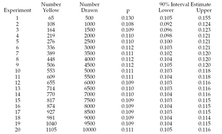

Submitted by Eduard Olivé on Wed, 04/14/2010 - 09:08
Adding samples
I have always read with the gratest interest your articles. In this case, I have doubts that 2 samples of size 500 each is the same as 1 sample of size 1000. In fact, if you calculate the proportion for each of the samples and the interval estimate for the population proportion, we get:
Experiment 1 2 3 4 5 6 7 8 9 10 11 12 13 14 15 16 17 18 19 20
# yellow cum 65 108 164 219 276 336 389 448 506 553 609 655 714 770 817 874 927 981 1040 1105
# yellow 65 43 56 55 57 60 53 59 58 47 56 46 59 56 47 57 53 54 59 65
Point estimate 0.130 0.086 0.112 0.110 0.114 0.120 0.106 0.118 0.116 0.094 0.112 0.092 0.118 0.112 0.094 0.114 0.106 0.108 0.118 0.130
Low 0.105 0.065 0.089 0.087 0.091 0.096 0.083 0.094 0.092 0.073 0.089 0.071 0.094 0.089 0.073 0.091 0.083 0.085 0.094 0.105
High 0.155 0.107 0.135 0.133 0.137 0.144 0.129 0.142 0.140 0.115 0.135 0.113 0.142 0.135 0.115 0.137 0.129 0.131 0.142 0.155
0.1 inside? Fail Correct Correct Correct Correct Correct Correct Correct Correct Correct Correct Correct Correct Correct Correct Correct Correct Correct Correct Fail
where 2 out of the 20 intervals don't include the correct population proportion 0.1 wich completelly matches our 90% confidence interval.
