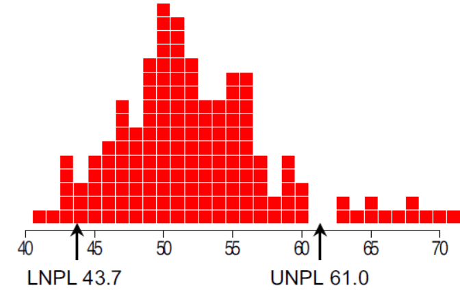

The histogram in Figure 1 represents 20 days of production for one product. It is clearly not going to pass any test for normality. But is there some other probability model that might be used?
