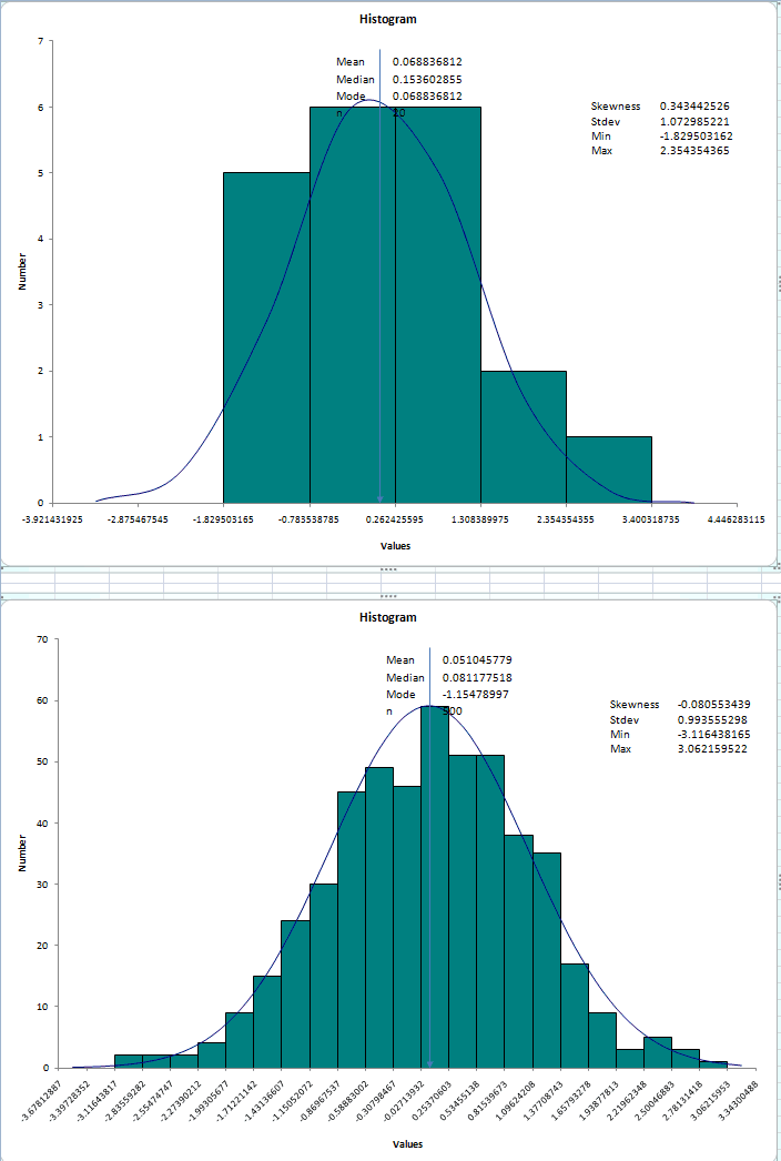

One of the exercises I assign to students in my training involves creating two histograms from normally distributed random numbers. The results often look similar to those shown in figure 1. When I ask students to comment on their histograms, I usually get comments about the averages, spread, and other statistical properties. However, that misses the point I’m trying to teach.
When we do Six Sigma, we usually spend a lot of time mining historical data from databases. Sometimes the sample sizes are large, and sometimes they can be quite small. In fact, even large sample sizes can become small when we slice-and-dice them, drilling down with various categories and subcategories in search of critical-to-quality data. Statistical software will often automatically fit a normal curve to histograms created from these data. It’s often tempting to use the fitted curves to make an eyeball judgment about the normality of the data. Sometimes this is a good idea, and sometimes it isn’t.

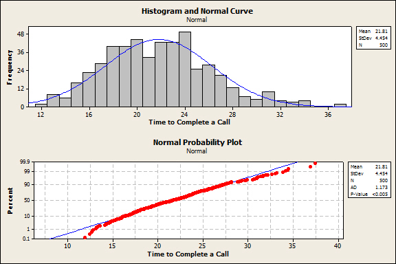

Use minitab normal prob graph with ci lines
Hi  Tom  I'm a MBB trying to build Transactional GB training material but need to use minitab. And for a very long time, i've used the normal prob graph to better show normal, non-normal and outliers.  To this point, I can ask real simple questions Like are all the dots inside the blue lines? CI Does the line in the middle look like it explains all the dots?   You must look at all dots out side the blue lines,.....  Next, see this picture what it looks like and see over here the p & AD numbers.  baby step     I have found this is much easier for the students get   Histograms have less formal visual rules   Also, make the look and break up sub groups and then if they are differnt see if there is any value?  maybe maybe not.     I have a few screen shots of an example if you have an interest in a ppt show.
I've had issues with people using histograms either out of novice or others with an agenda.  So, I think the normal graph is much more simple but more inforamation rich.
