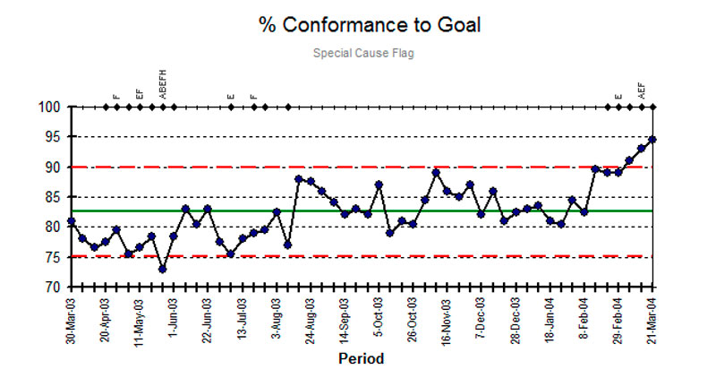

Some seminars even teach all seven control charts! And then there is the inevitable torturous discussion of "special cause tests" (usually the famous eight Western Electric rules). People are then left even more confused. Does each test signal need to be individually investigated, i.e., treated as a special cause? Not to worry—most people usually investigate only the points outside the control limits. The focus tends to be on individual observations. But what if there is one underlying explanation generating many of these signals that has nothing to do with individual outliers, e.g., a step change?

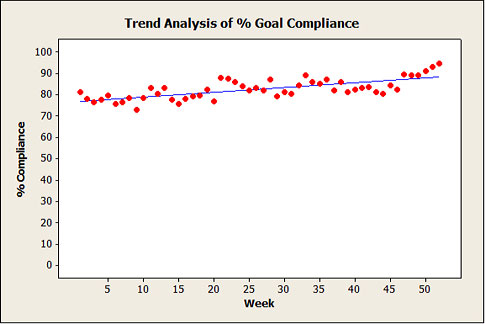

Someone once presented me with the graph shown in figure 1. (Yes, the y-scale started at 0.) It almost convinces you that there is a trend, eh?

Definition of "Trend"
Hello Davis:
What is your definition of "trend"?
Thank you, Dirk
Submitted by Davis Balestracci on Wed, 01/08/2014 - 12:17
Definition of "trend?"
Good question. I'm not sure. Actually, if I had my way, the term "trend" would be banished from corporate language unless used in the "qualitative" sense of "tendency." Whenever someone blurts out the term "trend" because it seems like the thing to do, why don't you ask them exactly what they mean -- you will get as many different answers as people whom you ask. My use in the article is to call it a "transition" to a new steady state based on changed inputs to the process.

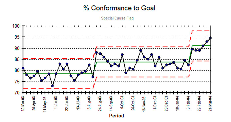

Careful -- one of the lingering myths about control charts is that they are to be used only on processes in control. HOW ELSE can you determine that the process is unstable? It could just be as simple as using a run chart to determine where there are step changes, as in my example. If you can't use a control chart at all, then your process could be in Dr. Wheelers state of "chaos" -- i.e., totally unpredictable. Even though at times it SEEMS as if this is true, how else can you determine it and then use it to look at the effects of your interventions? It NEVER hurts to begin by plotting some process data over time. Most statistics courses (enumerative) treat the process as if it's a "pond" and can be characterized by repeated sampling. In the real world (analytic), processes are more like whitewater rapids! You can maybe characterize one sample, but how would it compare to the next sample? And even though it might SEEM chaotic, it could still be "stable."

Your examples illustrate the importance of getting the whole picture of what is going on with the process, so that you can see when the control limits need to be re-assessed.
It was good to see actual dates/times instead of run numbers on a control for a change.

Why are you waiting a year before creating a control chart? The statistician that waits to get a year's worth of data may be a "hack" by not understanding the importance of responding to events (good or bad) as soon as possible after they occur.
The second phase is clearly seen using 2 out of 3 points beyond 2-sigma limits in the first control chart. However, if the chart had been used as a monitoring tool with signals to be responded to when they occur, the more powerful control chart would have been based on the first phase in which even one point would have been enough to signal a change.
In addtion, the article does not menton why the subgrouping used was appropriate for whatever purpose (also lacking) the control chart was intended to address.

Good questions...and I agree with you
Background: This occurred at the very end of a seminar and it was the first time I had seen the data. They wanted to use what I had just taught them for insight. Initially, I'm not sure there was any other purpose than "accounting for" their activity and using the trend to show that they had made "general improvement" -- i.e., there was no underlying process understanding or attempt to quantify the improvements. It was a passive use of a trend line to "see how we're doin'."
Regarding sub-grouping -- they had one point per week. At the end of the week, they looked at number of events and number of events that complied with a goal -- period. They had no idea about how many 'events' there were. What you suggest leads to maybe they could disaggregate by day-of-the-week to see whether certain days were special causes.
This is an example of what happens in many cases -- one has to take the data one is given and start from there to ask the questions that you pose. And the insights gained from this analysis form a good starting point for the questions. An "outsider" doesn't always have the luxury of planning a collection, but can certainly recommend a better plan. Many times, "hacks" are just concerned with applying tools and being pedantic about which ones. As Dr. Wheeler says, the purpose of analysis in insight.
