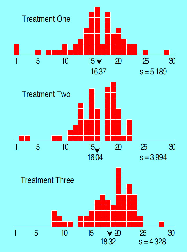

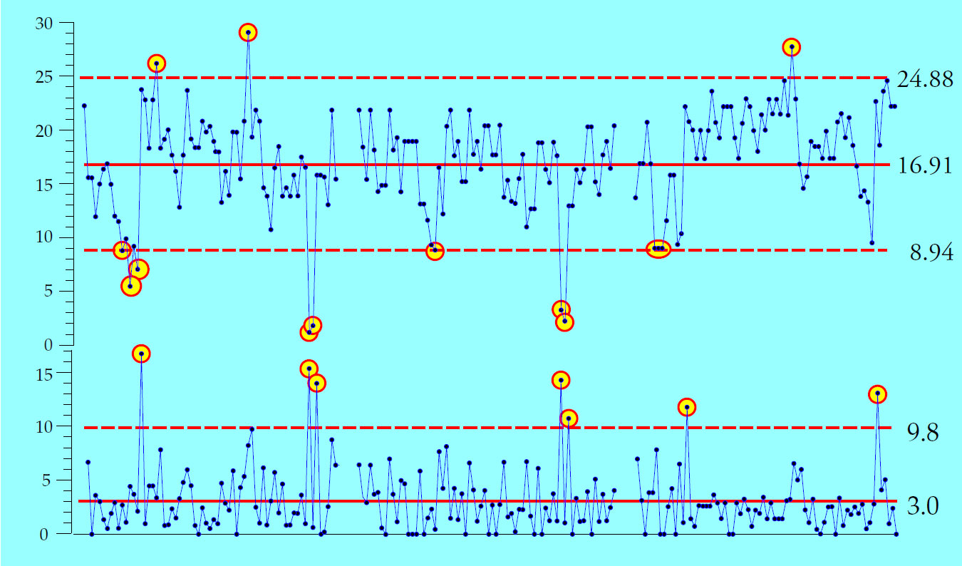

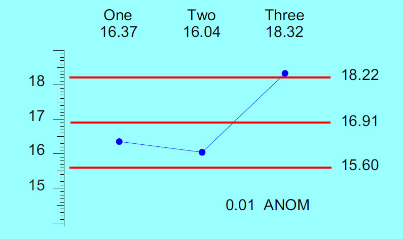

Last month we looked at analyzing observational data. Here we will consider experimental data and discover a weakness in the way they are obtained that can contribute to the problem of nonreproducible results.
Background
The discipline of statistics grew up in agricultural and biomedical research. There a major problem for researchers is the fact that their basic experimental units are fields, livestock, and people. Since these units all differ, any researcher has to find a way to keep these differences from masking the effects of any treatments being studied. And the classic solution for this problem is some form of randomization.
