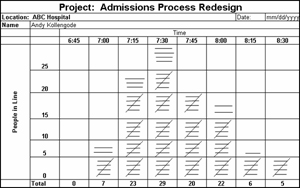

he check sheet is a simple and effective tool useful in lean Six Sigma projects. It is sometimes referred to as a concentration diagram or location plot. It is a handy tool for qualitative and quantitative data gathering and analysis. Check sheets help to systematically collect and organize data and are useful in all phases of the define, measure, analyze, improve, control (DMAIC) statistical and analytical method used in lean Six Sigma.

People sometimes confuse a check sheet with a check list. The list we use for groceries and the report you get from the auto repair shop with items checked off after service (oil, filter, tire pressure, tread, etc.) are examples of a check list. The following table highlights some key differences between a check list and a check sheet.

A tally sheet to collect data on frequency of occurrence
