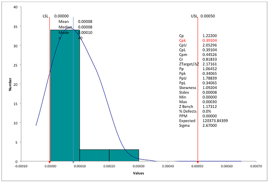

A few days ago we received an email from a friend at a machine shop. He had just finished a process capability analysis for a critical feature (a runout on a cylindrical part) and was shocked by the output. The spreadsheet software he used showed him a process capability (Cpk) of 0.39 (see figure 1 below).
To put this in perspective, with a Cpk of 0.39, he should be seeing a nonconformance rate of between 12 percent and 24 percent, assuming a stable process and a normal distribution. However, he was actually experiencing a nonconformance rate close to zero. In fact, he hadn’t had any problems with runout as far back as he could remember.
Figure 1: Runout histogram. Click here for larger image.
Submitted by knowwareman on Wed, 11/27/2013 - 22:11
Calculating Cpk when there is no LSL
In this example, there is no LSL, just an upper specification limit (USL).In the QI Macros, if you specify the USL with no LSL, Cpk=Cpu would be 2.05 instead of 0.39.
We could substitute median for the average to get 1.91, but in either case Cpk is much greater than 1.66 (5 sigma) and close to 2.0 (6 sigma).
Yes, in this case a median will be a better measure of central tendency, but do we really need a micrometer or is this yardstick good enough? While Average could easily be changed to Median in the QI Macros Histdata worksheet, would it tell a better story?
The QI Macros do have a true position Cp Cpk template for GD&T calculations (using variation both from X and Y coordinates).

Thanks for the explanation of the features in qimacros. Sounds like a good product. Yes, in this case, the difference in calculations was not large, but given a different distribution, we could see very different results. In any case, the larger point is that the user needs to understand the “nature of the specification” and the type of distribution he or she is dealing with, and understand the relevant process capability measure (Cpu in this case). Nipun & John
