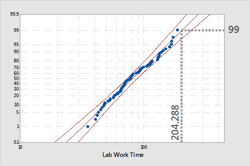

Figure 1: Estimating the 99th percentile on time to complete hospital lab work. Probability plot generated with Minitab Statistical Software.
A probability plot is most often used to help you determine whether your data follow a normal distribution (based on how linear the points appear to be). It provides a good starting point for understanding percentiles. A percentile is the value at which a given percentage of the population is estimated to fall below.
But did you know probability plots also provide estimates of the percentiles of the distribution? You can choose any percentile you want on the Y axis and find the corresponding data value on the X axis. The corresponding confidence intervals on the probability plot are confidence intervals for the specific percentile.
I was recently working on a project with a hospital that needed to estimate within how many minutes 99 percent of its pre-surgery lab work falls.
The X value corresponding to Y = 99 on the probability plot was 204 minutes. In other words, 99 percent of all pre-lab work should be complete by 204 minutes.
The confidence interval around the estimate indicated that we could be 95-percent confident that 99 percent of the lab work would be complete by 171–244 minutes. This explained why the surgeries were often falling behind schedule.

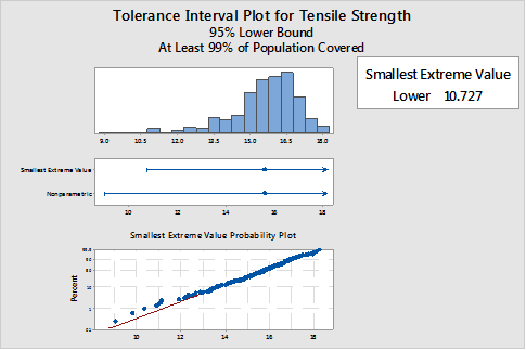

Figure 2: Tolerance interval plot generated with Minitab Statistical Software.
Although percentiles estimate the percent of observations that fall below a certain value, tolerance intervals provide a range that you can be confident a certain percentage will fall between.
They are very useful for determining where a certain percentage of the population will fall relative to your specification limits.
For example, a medical device company I was working with needed to show 95/99 reliability on the tensile strength of plastic tubing. The specific requirement was that it needed to be 95-percent confident that the tubing would withstand 3 lbs of force for 99 percent of product.
Like the hospital data, these data were non-normal. Because a tolerance interval estimates what is going on in the tails of the distribution—not the mean—the distribution assumption is important. Here, an extreme value distribution provided a good distribution fit. Because the tubing could not be too strong, a one-sided tolerance limit, a lower bound, was appropriate. The value of the 99-percent lower tolerance bound with 95-percent confidence was 10.7 lbs. In other words, we could be 95-percent confident that 99 percent of the tubing population has a tensile strength of at least 10.7 lbs—well above the specification limit of e lbs.
