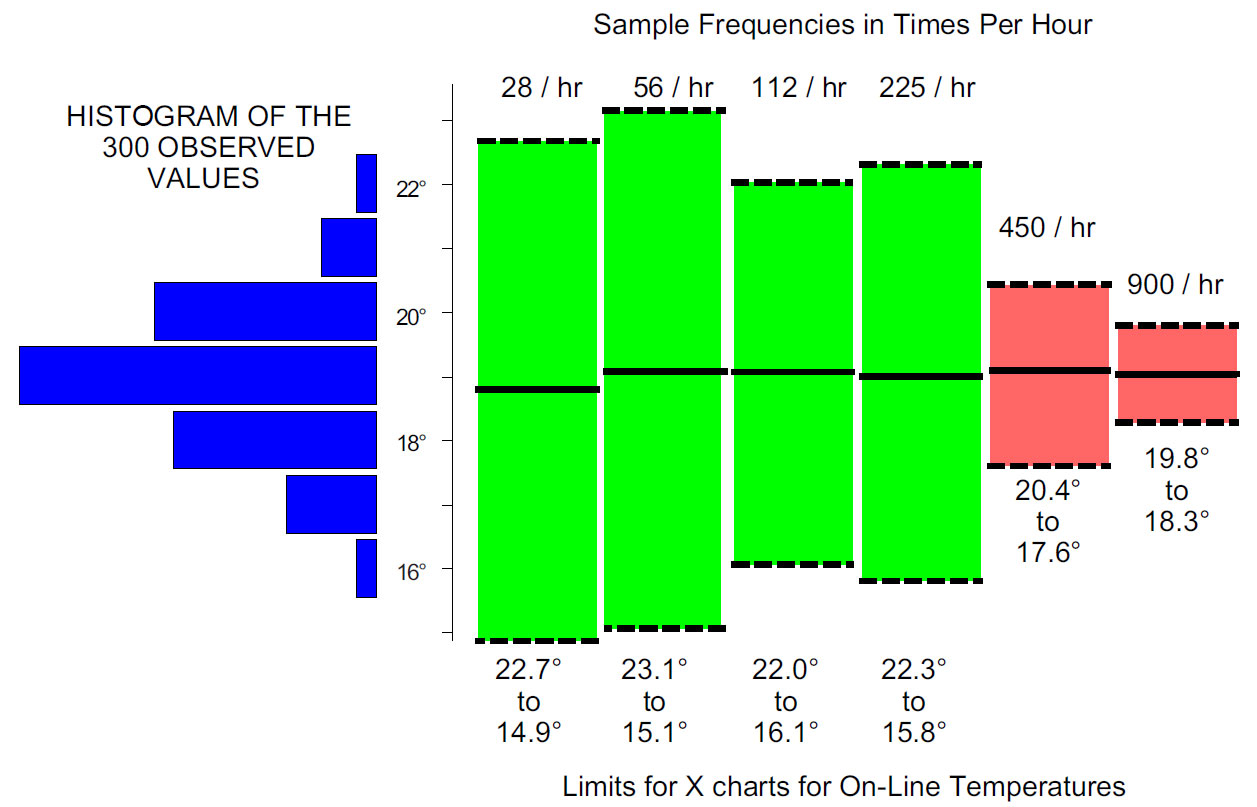

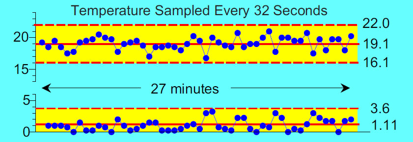

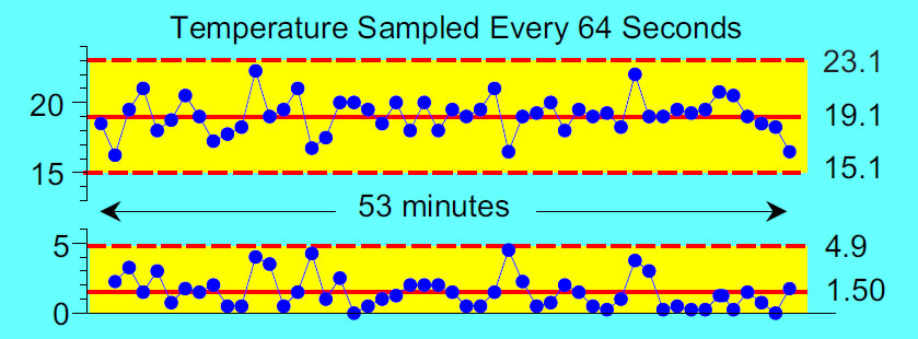

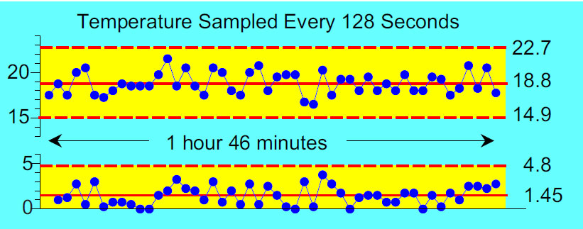

The keys to effective process behavior charts are rational sampling and rational subgrouping. As implied by the word rational, we must use our knowledge of the context to collect and organize data in a way that answers the interesting questions. This column will show the role that sample frequency plays in constructing an effective XmR chart.
One of my clients had an online temperature gauge that could be sampled at different frequencies. The process engineer wanted to use these data to create a process behavior chart. He began by sampling the temperature once every 128 seconds, resulting in a sample frequency of 28 times per hour. The resulting XmR chart is shown in figure 1.
Figure 1: Temperature sampled 28 times per hour

Thanks for raising this question.
Rational sampling combines the context for the process and the purpose ofr the charts.  It always requires judgment about what kind of process changes might occur and how fast they might show up in the data.  Remember, we are not concerned with every little process change, but only those that are large enough to be of economic consequence.

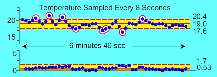

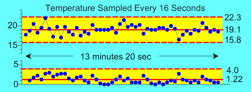

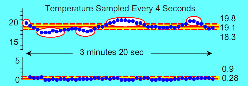

I recommend starting with a higher sample frequency rather than a lower for exactly the reasons you note.  However, when we reach a frequency that will allow the subgroup ranges, or the moving ranges, to capture the routine process variation the limits will stabilize.  If the limits simply continue to shrink with increasing frequencies your initial frequency may have been too high.
When the limits stabilize you have empirical evidence that you have the right frequency.  This empirical evidence should be used along with the context to get useful charts.  When confronted with a process that produces data at a high frequency I tend to start with the running recod and look at the overall bandwidth of that record.  Is it steady or does it meander around?  This is just one more empirical trick to help with the judgment involved in rational sampling.  As my colleague Richard Lyday used to say, we should always think first, then think statistically.
