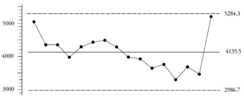

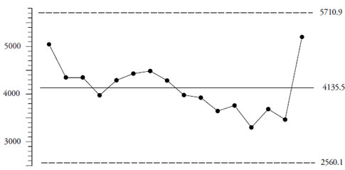

In my column of Jan. 7, “The Right and Wrong Ways of Computing Limits,” I looked at the problems in computing limits for average charts. This column will consider the right and wrong ways of computing limits for charts for individual values. As before, a data set will be given that you can use to evaluate your own software so that, hopefully, you can select an option that results in the correct limits. But first, some history might be of interest.

I do think that the "problems" with using the statistical estimate of the standard deviation need to be revisited. Some things to consider:
1. The example provided by Dr. Wheeler has a run of 7 points in a row below average, which by many authors (but not Dr. Wheeler, who uses 8 points) to be a signal, which would cause that data not to be put all into the same baseline.
2. In 16 years of operational SPC, I have yet to run into an example from real world data where the moving range and the statistical standard deviation provide two different interpretations of what is and what is not an outlier.
3. With modern spreadsheets, the statistical standard deviation is easier to calculate rather than the moving range conversion. That is the opposite of the situation for pre-computer days, when the moving range was developed.
4. Dr. Shewhart himself, in Economic Control of Quality of Manufactured Product evaluates several methods for determining the spread of the data, and he rates the statistical standard deviation as best (better than the range).
5. Dr. Shewhart and other authors do invoke the Tchybychev Inequality as the theoretical basis for SPC. The Tchybychev Inequality is non-parametric and uses the statistical estimate for the standard deviation. The moving range formula (2.66 times the average moving range) has the Normal distribution built into it as an assumption.

1. We do not have to prequalify our data prior to placing them on a chart. These are simply the first 16 values out of Shewhart's larger data set. They are sufficient to show that the process is changing.
2. It only takes one counterexample to shoot down such a theory. The example provided is a real world data set where the two computations give different results.
3. Yes, lazy bones can compute the standard deviation easily. Unfortunately, this computation makes a strong assumption of homogeneity, which is essentially what we want to examine.
4. Dr. Shewhart did compare the root mean square deviation with the Range and correctly noted that there is a difference in their efficiency when the subgroup size gets large. He also notes that the differences are minimal when n is less than 10. In 1935 he was instrumental in writing the ASTM Supplement B which gave the scaling factors for using the range, so he was okay with this approach.
5. If you read Shewhart very carefully you will find that he rejects the Chebychev approach as not being sufficiently general to do what he wanted to do.
In general, the choice of statistic is not the issue, but rather the computation of within-subgroup measures of dispersion versus the computation of global measures of dispersion. You simply cannot change the underlying mathematics, no matter how many times you may read things to the contrary.
Hope this will help.

In an attempt to advocate the calculation of control limits of XmR charts by avrg. mR * 2,660 over the use of a global dispersion measure (the global standard deviation) I evaluated sets of our real world data (quality characteristics measured as one value per batch) and compared limits for both ways of calculation. What i found was limits beeing inflated as well as limits beeing deflated in some cases. I checked my calculations and couldn`t find a possible error so far.I could also not find the cause for deflated limits.Can deflation of the limits happen?Is it also "only" due to inhomogeneity of the data or is there a more specific reason behind it?I suspected short periods of decreased dispersion in the data from visual examination of the run charts but couldn`t find that systematically nor pin it down mathematically
All my arguments seem to be obsolete now because i claimed, that limits could be inflated in the first place and now have to admit, that deflation of limits is also possible and in fact it might be seen as an optional choice for favouring the method of calculation giving wider limits in the majority of cases over the other one.
I would be really thankful about hints on this issue!
Submitted by Donald J. Wheeler on Fri, 09/09/2016 - 06:55
In reply to deflation of control limits by using global dispersion measure by hmindler
Response for HMINDLER
I would be glad to discuss this directly with you.
Your results might be due to your approach.
If the data come from a random number generator, then what you report may well be true.
But when comparing limit computations using non homogeneous data, the use of the average moving range
will result in tighter limits than any approach using a global measure of dispersion.
