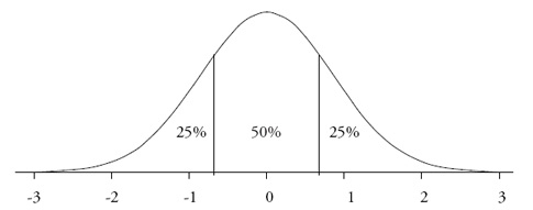

Figure 2: The middle 50 percent of the normal distribution

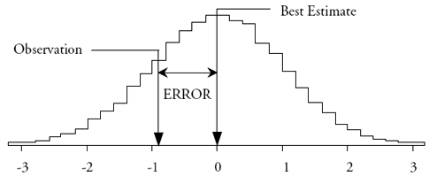

Figure 3: The error of a single measurementThe intraclass correlation

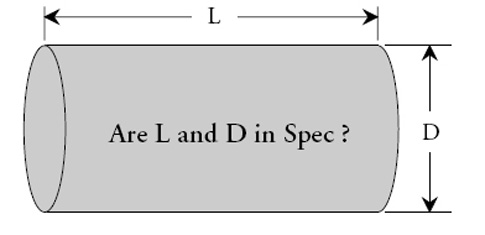

Figure 4: Using a measurement for description
• Your measurement increment should not be larger than 2 probable errors.
• Your measurement increment should not be smaller than 0.2 probable error.Characterization

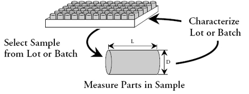

Figure 5: Using a measurement for characterizationRepresentation

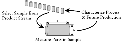

Figure 6: Using measurements for representationPrediction

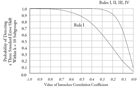

Figure 8: How measurement error affects our ability to detect a three sigma shiftSummary
