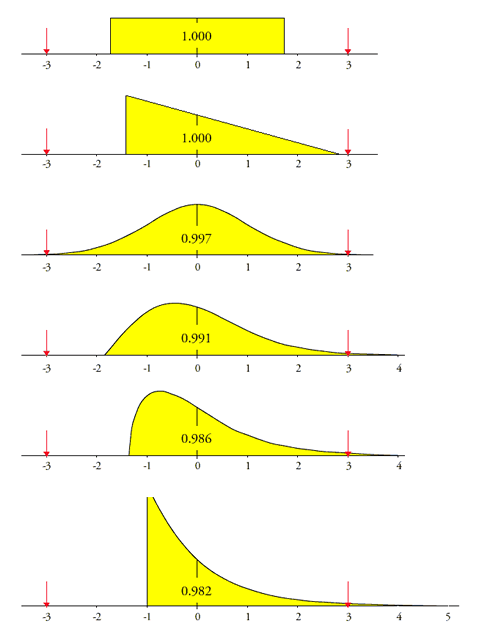

The symptoms of leptokurtophobia are (1) routinely asking if your data are normally distributed and (2) transforming your data to make them appear to be less leptokurtic and more “mound shaped.” If you have exhibited either of these symptoms then you need to read this article.
The origins of leptokurtophobia go back to the surge in statistical process control (SPC) training in the 1980s. Before this surge only two universities in the United States were teaching SPC, and only a handful of instructors had any experience with SPC. As a result many of the SPC instructors of the 1980s were, of necessity, neophytes, and many things that were taught at that time can only be classified as superstitious nonsense. One of these erroneous ideas was that you must have normally distributed data before you can put your data on a process behavior chart (also known as a control chart).

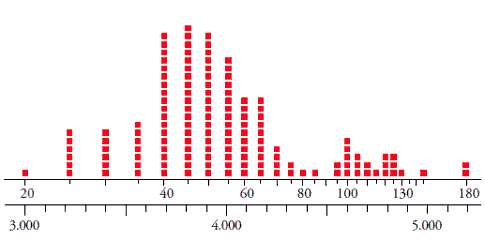

Submitted by mhardie on Tue, 08/11/2009 - 12:38
Great Article - is there an error?

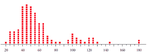

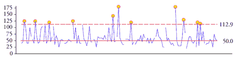

I see an error when I ran the numbers. I ran the 141 observations for the hot metal tranist times and get 59.9 for the average and putting these into the individuals chart in Minitab yields 3 points out of control, not 11 points.
But, Love the article! Great lesson here!

The idea that the false alarm rates are comparable for the various distributions shown in figure 1 is not correct. Anyone who has ever made an Individuals control chart with highly skewed data knows that the false alarm rate can be quite high. The reason is that the data in the figure have been standardized based on the overall standard deviation, while an Individuals control chart typically uses the moving range as an estimate of variation to determine control limits.
With highly skewed data such as that shown in the bottom two distributions, the data is more bunched up and the average moving range is smaller than that of the normal distribution - therefore, although both may have the same overall standard deviation, the control limits for the skewed distribution will be tighter and therefore we expect a larger false alarm rate. A quick simulation using 10,000 data points that are normal and 10,000 which are skewed - both standardized to a mean of 0 and overall standard deviation of 1 - shows a false alarm rate of .0021 (0.21%) for the normal data and .026 (2.6%) for the skewed data. I don't think most practitioners want a 12-fold increase in their false alarm rate, especially given the resources that frequently go into finding out the "special cause" of an out-of-control point.
While I agree transformations may be overused or frequently used in cases in which they are unnecessary, I have to also side with those that have a good transformation and choose to use it when establishing control using an Individuals control chart and skewed data.
