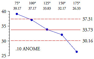

You have 30 seconds to make your point before your boss’s eyes glaze over, and the easiest way to beat this 30-second rule is to use a graph. In thinking about how to beat the 30-second rule Ellis Ott decided to combine the graphic power of the average and range chart with the sensitivity of the analysis of variance (ANOVA). The result was the analysis of means (ANOM). The original version in 1967 used approximate critical values to compute the ANOM decision limits. Over the years several investigators have worked on sharpening up and extending these decision limits. The tables given here are excerpted from the results of the latest such revision carried out during the past two years. However, before we get to the ANOM, we shall begin with the traditional ANOVA.

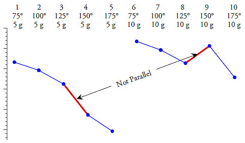

If it were me having the test results presented to me, I would want to see a simple line graph with reflectivity on the y axis, temperature and the x axis, and a line for each concentration.  In one view of the chart I could understand.  All that needs to be communicated would be there.
Submitted by shrikale on Fri, 01/10/2014 - 11:08
In reply to Too complicated by Dave Y
Genuinely Curious
Hi Dave,
Maybe I'm missing something, but isn't Fig. 3 just the chart you're describing, but without decision limits?
Without decisions limits, how would you determine if the differences were real?
Without the ANOME charts, how would you determine the size of the main effects?
My questions are out of genuine curiosity. If you have a better faster easier way to determine these things, I would love to learn them and put them to use.
Thanks for your time, Shrikant Kalegaonkar (LinkedIn: http://www.linkedin.com/in/shrikale/, Twitter: @shrikale)

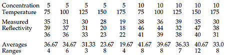

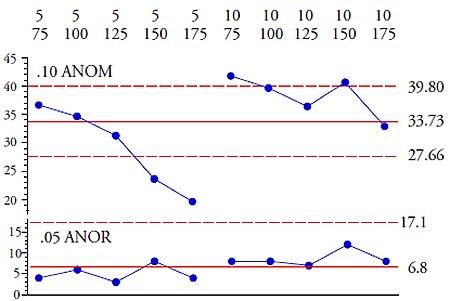

Question on Range Chart Scaling Factor
Hello Dr. Wheeler,
Your post provided a slightly different approach to the example in "Understanding Industrial Experimentation". It's a cleaner way to determine the decision limits using Table A & the average R. Also, your point made in Fig 6. was much clearer. So, thank you for that.
I did have a question with respect to the range chart and the way the range limit is determined. I used the control chart factor D4 to scale the average R to get the upper limit. For n = 3, D4 = 2.574. However, in your post you use 2.519. Can you help me understand the difference?
One other question: Is it possible for a difference to show up in the ANOVA and not in the ANOM? Is one approach more sensitive or less robust than the other?
