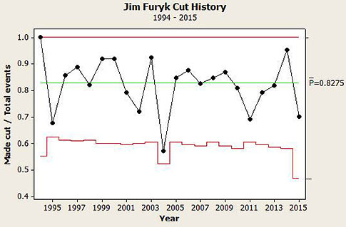

Submitted by Scott A. Hindle on Wed, 06/17/2015 - 02:35
Use of a run chart?
Thinking back to Tiger's golden years (e.g. 1995 to 2005 perhaps?), would a run chart of his combined 1st two round scores show he was consistently "different", i.e. better than the rest of the field? Perhaps his more recent scores would give a clear statistical signal of his powers waning?
I remember, come the final day, Nick Faldo was always in the reckoning for many years, perhaps his low-scores in the 1st 2 rounds would consistenly show him as an outstanding performer (in the 90s?).
Perhaps even Greg Norman, going back 15 to 20 years perhaps, would give a signal with his final round scores when he often went into the final round top of the leaderboard but failed to come away with the trophy due to a last round of perhaps 75 or 76? Was Norman's performance in these final rounds due to common cause or evidence of some potentially identifiable assignable cause affecting his game?
Here I'd be curious to see which technique/s you'd recommend if we included this year-by-year time element in the process as well.
thanks, scott.
Submitted by Davis Balestracci on Fri, 06/19/2015 - 09:42
In reply to Use of a run chart? by Scott A. Hindle
I think you're onto something, Scott
Good comments and suggested analyses!  The data are easily available should one wish to do it.  I think I gave a good example with Jim Furyk's cut history and citing the recent performance of the 2003 champion.  Isn't is amazing what simply plotting data over time can do?
Davis
