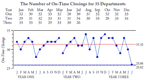

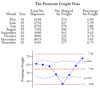

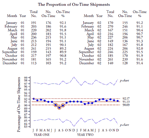

What I never see mentioned in the advocacy of XmR charts is that the control limits can be highly sensitive to the chronological order of the data. In Dr. Wheeler's Figure 4 Premum Freight Data example, the order of the data can make the XmR chart control limits as wide as 1.5 & 9.2, or as narrow as 4.2 & 6.5 (roughly the same as the p-chart limits in this case). To claim that the limits obtained for the particular order presented to be the "correct" limits ignores this variability. What if the various percentages had occurred in a different order? Similarly, in the Figure 3 example of On-time shipments, the data suffered particularly from autocorrelation, making the XmR chart limits much narrower than if the autocorrelation had been absent. If the order of the data had been different (reflecting less autocorrelation), the three points below the lower limits would then have been above the lower limits.
