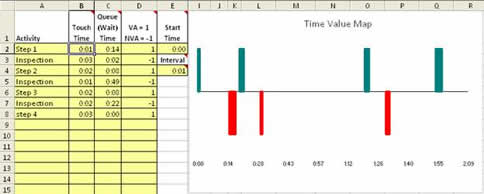

Here is an example of a time value map. Any bar above the center line is value-added (VA). Any bar below the center line is nonvalue-added (NVA). The center line represents the timeline for the process, from start to finish. The gaps between bars are assumed to be no-value added delays (i.e., queue or wait times) and can be eliminated with value stream mapping and spaghetti diagramming. From a lean perspective, the goal is to eliminate the NVA and delays to accelerate the process.
