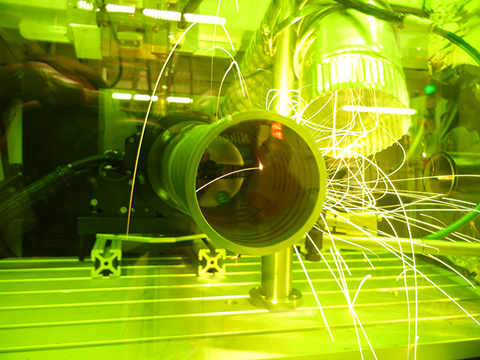

Act I: Creating a keyhole
The laser welding process begins, as one might imagine, when a laser is focused to the surface of a metal. Although the surface initially reflects most of the light, it absorbs enough to cause significant heating. This heating slightly changes the way the metal interacts with the light, which in turn causes more absorption and even more heating. Once the metal gets hot enough, it begins to melt and evaporate.
