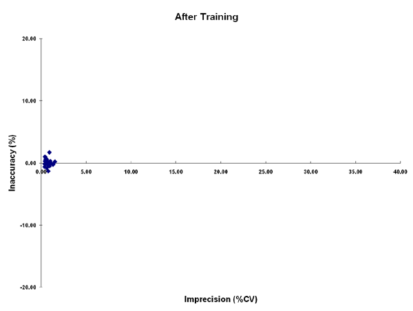

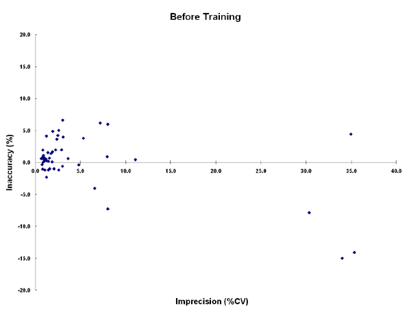

The pipette is a reliable precision instrument that has been used and trusted for many years. However, as with many forms of instrumentation, a pipette performs only as well as the operator’s technique allows. Differences in technique—some more than others—can alter delivery volumes and affect data integrity. As your laboratory’s demand for accuracy and precision increases, so too does the importance of understanding and developing optimal pipetting technique.
The following tips will help you produce accurate and precise laboratory results through a proper pipetting technique:
