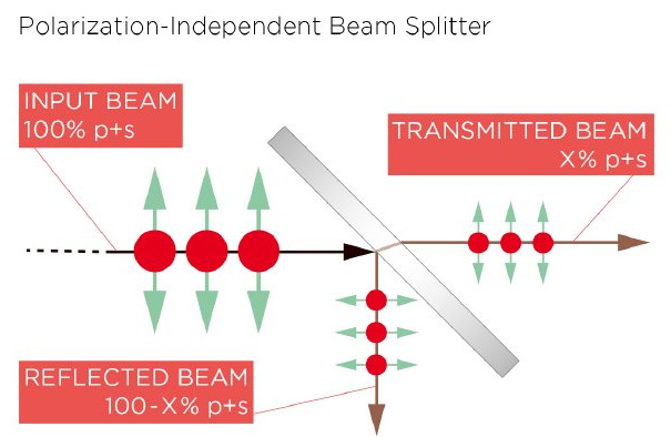

Improved design of polarization-independent beam splitters

These optics are used for real-time measurement of laser power in applications in which the polarization of the laser beam can change. For example, |Rs-Rp|<0.2% applies to the reflectance values, thus the ratio of s and p polarization does not change during beam splitting.
