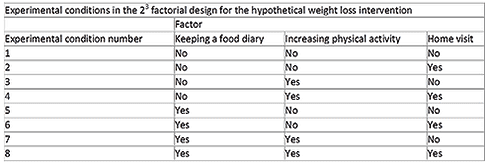

Trust me, there is no way you could make up the things busy people will do to (unintentionally) mess up your design and its data. “But I just want to run a simple 2 × 2 × 2 factorial,” someone might say.
