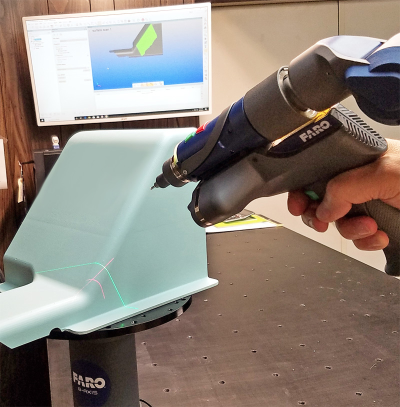

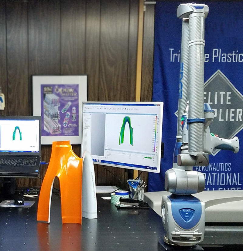

More than five years ago, the Tri-State team scheduled an on-site demonstration of the FARO Platinum ScanArm fitted with a hard probe.
“I was truly impressed with the speed and accuracy of the ScanArm,” says Peterson. “With the ScanArm, you could get in minutes the data that would take hours with a fixed CMM. Later that day the owner asked what I thought of the FARO presentation. My response was, ‘Find a way to buy it. It’s exactly what we need.’ We purchased our first FARO arm shortly thereafter, and it’s provided years of good service.”
Tri-State subsequently added an Edge ScanArm in 2015, and deployed a FARO Quantum 8-Axis ScanArm in 2019.

As customers became aware that Tri-State was using FARO technology—and the capability this afforded—they began receiving more opportunities that required additional GD&T and CAD-based inspection.
“We came to the realization that we probably couldn’t do all of the inspection we needed to do with just the one ScanArm that we had,” reveals Peterson. “We asked Matt Wirginis, our FARO rep, to come in and lay out some options for us. Matt has always been helpful anytime we needed anything. He’s always made himself available to us with technical support as well as sales. Matt suggested we take a look at laser scanning rather than just probing.”

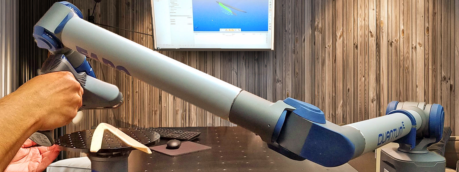

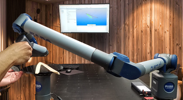

Mike and Marc Lopez. owners of Tri-State, decided to purchase a QuantumE ScanArm with a laser line probe and a Quantum 8-Axis rotary table. The facility now has two fully operational FARO workstations with probe and scan capability.
“Matt proved to us the value of having scan data that we could check CAD-based parts with,” says Peterson. “It’s also great to have evidence of conformance that our customers can immediately and easily see.”
