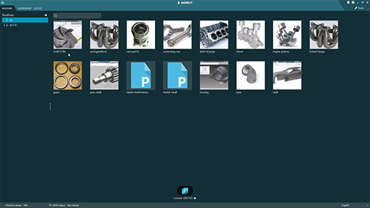

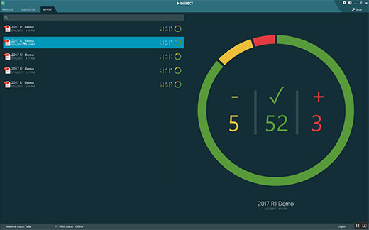

Repetitive manufacturing calls for a highly-controlled execution workflow to achieve a stable and efficient process. The whole point of a closed-loop manufacturing process is to keep it going, and the best way to do this is to avoid delays due to decision making at the inspection system. If implemented properly, the only real decisions that need to be made at the inspection system after initial startup are the selection of the inspection plans. For this purpose, PC-DMIS developers have created a new standalone application, INSPECT, which is a user-friendly interface that makes the selection and organization of inspection plans intuitive and convenient for the operator. Although INSPECT was primarily made with the operator in mind, it also includes administrative tools to assist with the deployment and maintenance of those inspection plans. On the administrative level, INSPECT enables the defining of directories where inspection plans can be accessed for execution, as well as built-in version control. For example, INSPECT always checks and indicates the version of PC-DMIS it connects to and automatically runs the last version that was used by an administrator when connecting to the PC-DMIS host. INSPECT acts as a client interface to PC-DMIS, while PC-DMIS runs in the background. It is through this client-host implementation that the main interface is kept lightweight, flexible, and version safe.
INSPECT provides a user interface exclusively for the operator that is simple and intuitive to use, while clearly communicating essential results for the successful execution of the inspection system. These objectives are achieved through the modularity of the solution as a standalone application and through the simplicity of its interface. Through its modularity, it can be easily added on top of an existing PC-DMIS installation, and utilizes the operator's existing inspection plans. Through its simplicity, it can be easily used so that little or no training is required. By reducing the number of choices in its user interface, significant improvements can be made in workflow efficiency at a critical point in the manufacturing process.

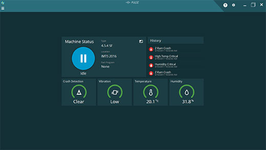

Monitoring the execution of the measurement system is one of the most overlooked aspects of a closed-loop manufacturing process. A great deal of work goes into perfecting the plan and then setting up the machine, but what about maintaining its execution? If at any point the measurement system stops due to an environmental disturbance, then the entire closed-loop process is affected as well. The production process relies on the proper function of its sensing element, i.e., the inspection system. It is not merely enough to have a well-tested inspection plan or machine interface that is easy to operate, because disruptions will always occur.
Historically, many companies accept the notion that an operator must be present to monitor a machine, but this not an efficient use of labor resources. If the inspection system is always susceptible to interruption and needs to be watched, then remote monitoring is the answer. This is the ability to monitor and react to disturbances without physically watching the machine, and it is exactly where PULSE comes in. PULSE is a remote environmental monitoring software designed with the internet of things (IoT) in mind. The system monitors the measurement execution status along with several typical environmental causes for interruption or failure in the measurement process, including vibration, temperature, humidity, luminosity, and air pressure. Not only are these environmental conditions monitored, but they are recorded to provide the actionable information needed to keep the manufacturing loop closed and continuous.

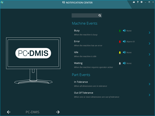

In addition to offering a way to monitor your measurement routines away from the measuring system, Hexagon is also improving the hardware for a better user experience for the operator. Some of these improvements include status and work piece lighting. One example of this is the PC-DMIS Notification Center, which is a new solution that enables the configuration of status lighting and sound events for different inspection system warnings. Status lighting can be configured to show warnings on both monitors and external light stacks. Status lighting gives the operator a quick view of the inspection system from across the shop floor while an inspection plan is executing. This provides operators with a means to manage a greater number of inspection systems at once and to perform other value-added tasks during production. If production is interrupted and the operator needs to intervene, then improved workspace lighting enables easier diagnosis of system errors caused by probe-related errors, work piece setup, or the work piece itself.
