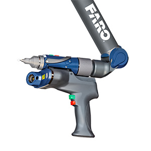

The FAROBlu™ Laser Line Probe HD high-definition camera uses the most advanced complementary metal-oxide semiconductor (CMOS) technology to deliver fast frame rate (the number of times per second that the camera gathers new data on the part being scanned) of up to 300 frames per second. This equates to approximately three times faster scanning than currently available with red laser technology.
FAROBlu laser line probe HD
Because blue laser has a shorter wavelength than red, a blue laser can deliver improved scanning results due to its intrinsic higher resolution, with a 50-percent reduction in speckle noise.

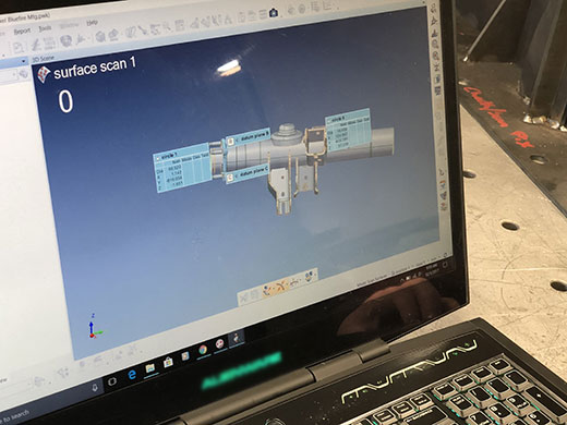

“Another reason we like the FARO laser scanner is we’re not only inspecting the profile of the part, but the laser scanning is giving us real-time information relative to the form for the part as well,” says Jon. “So, with the color mapping and all of the information that we generate through the laser scanner, we’re also able to identify if the sample part and form that a customer sends us matches their own math data.”

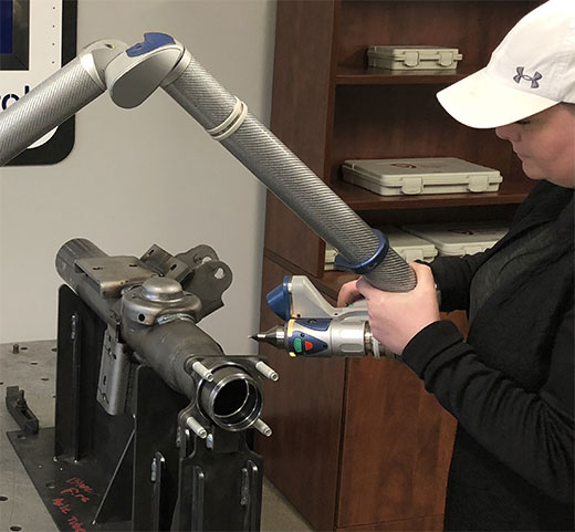

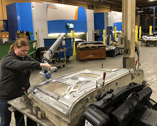

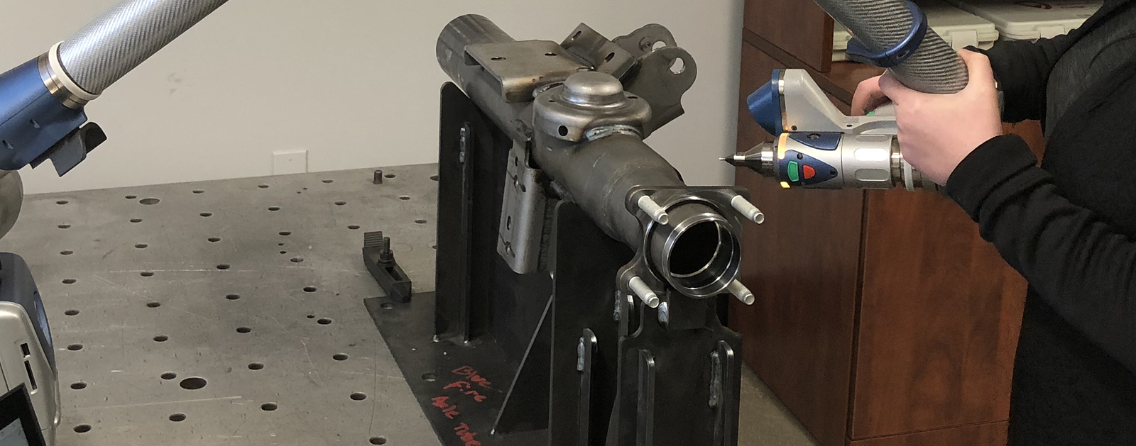

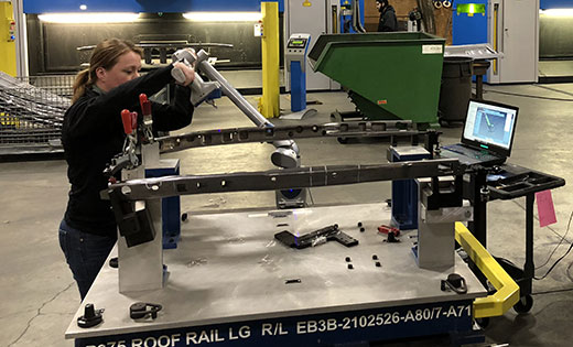

“Portability is big, being able to go out on the floor,” says Nick. “Sometimes we have parts that are just really large, and we have to scan them in three passes and then marry that data up together. And we have to do that on the shop floor because we don’t have a quality room big enough to deal with really large parts.
FARO Blu-Blue light laser scanner
“If we’re dealing with a large part, we’ll take the ScanArm out on the floor and set up out there,” says Nick. “We have the vacuum cup mount and the magnetic mount, so we can put it virtually anywhere out on our floor and use it. If it’s a smaller part, we set that up in our quality lab.
“The FAROBluTM also has temperature compensation for those hot summer days,” he adds. “As you let it acclimate properly, you’re not affecting your scan data because it has that technology built in.”
