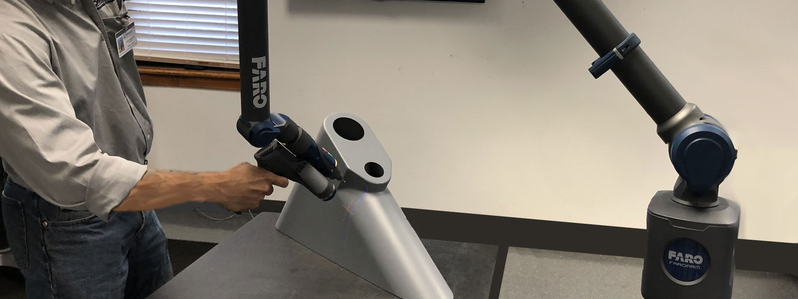

Like many manufacturers, Composiflex’s history includes inspection tools such as calipers, rulers, radius gauges, angle gauges, and micrometers.
“Prior to implementing FARO solutions, inspection bottlenecks slowed production considerably,” admits Sutter. “Previous solutions were unable to consistently meet tolerance specifications and precision requirements. They were not able to inspect large parts or complex geometries. Measurement repeatability was also an issue.
“We are now actually seeing new business opportunities through higher productivity and being able to meet tighter tolerances. This is a direct result of improved customer satisfaction.”
One of the things that sets Composiflex apart is its commitment to reinvesting in tools that enable improvement.
“Several years ago, we wanted to make investments to improve our capabilities and automation of processes like inspection,” explains Matthews. “We originally purchased a non-FARO brand 3D scanner. We liked the technology, but we chose to invest in FARO products because we found they had more capabilities and were easier to use. First, we purchased an Edge ScanArm with an SD scanner. Our team valued that piece of equipment so much, we decided to further expand our capabilities with a Quantum ScanArm probe fitted with the HD scanner.”
“Utilizing the Quantum ScanArm has resolved many of our resource issues and eliminated days’ worth of measurements, calculations, and reinspection to confirm results.”
—Rhonda Sutter, quality assurance manager at Composiflex
